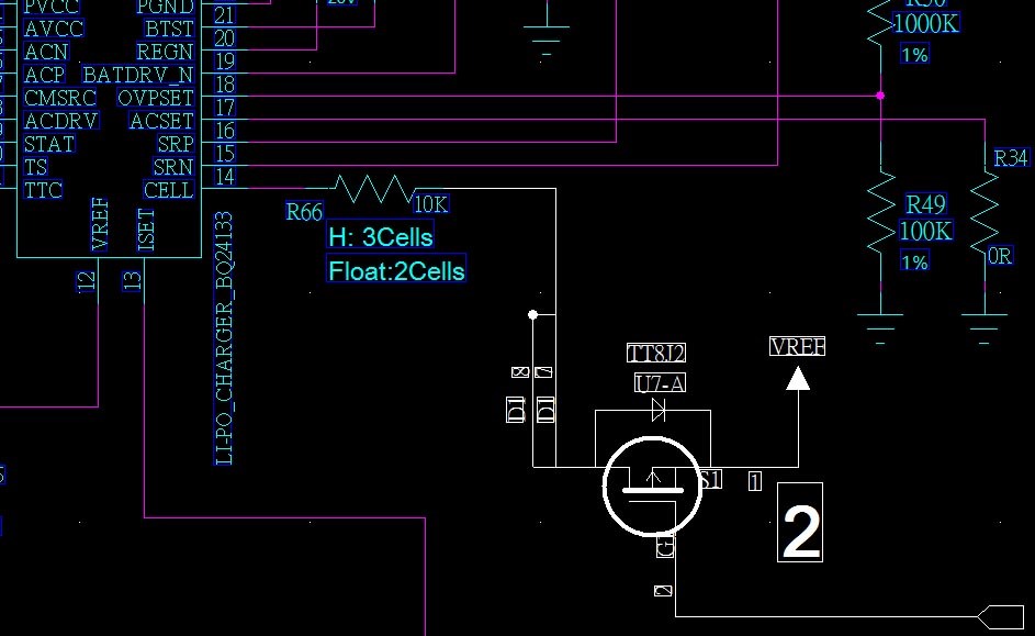

I am using BQ24133 to design a 2Cells and 3Cells charging circuit. I know that the pin 14 "Cell" is using for select cell number.
High for 3Cells, Float for 2Cells. Refer to the following picture, is that possible to use a P MOSFET for select High and Float states?
Many thanks
    Yes, you can select between cell pin settings using external circuitry.
