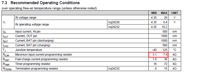

Hi Team,
There is the following chart in datasheet page.6.
I believe the red part is typo and 2.75 - 8.4kohm is the correct.
Could you modify it?
Yaita
Yaita,
The recommended range is calculated using the typical value of KILIM instead of min and max.
Wenjia
3.1 kohm to 7.8 kohm is correct. The datasheet is being updated to reflect it.
Wenjia
