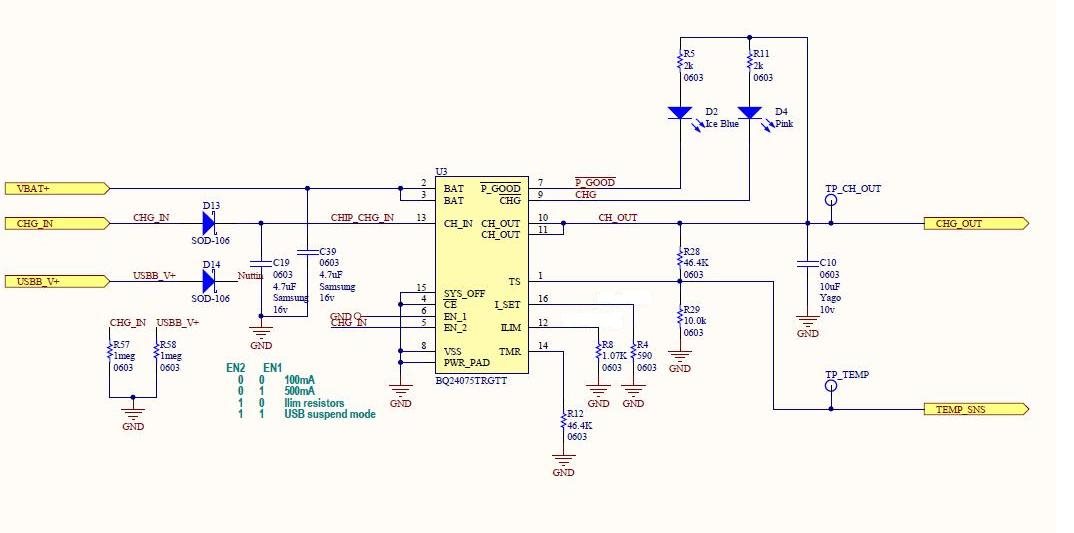

Hi all,
I have a design with BQ24075TRGT implemented on it. I encountered the following problem:  after about 2 weeks of use the   BQ24075TRGT stops charging. When I replace the charger IC on the malfunctioned board, it starts charging again, so from this I understand that the malfunction part is the IC itself. the input current is limited  to the maximum current of the IC (1.5A~) , and the charge current is also set to 1.5A~.
The practical measured current on the circuit is 1A total, half of it charging the battery.

  • You mentioned that the charging current is set to 1.5A so what did you mean by "half of it charging the battery"? Did you mean 1A is going to the output load and 500mA is going to the battery so there's 1.5A output current in total?
    It is hard to say what is the root cause of this. Can you share the schematic?

  • Wenjia,
    Thanks for replying. Let me explain myself more clearly: what I meant to say is that the IC limits are programmed to 1.5A (i.e. Riset is 590ohm, and rilim is 1.07K, that is they are both set to about 1.5A limit), but when I measure the current on the circuit I see 1A at the CH_IN terminal, and 0.5A at BAT terminal. That means that as you said the 500mA are going to the load and 500mA is going to the battery.
    I will try to get approval to publish the schematics, but it's pretty much as the datasheet connection diagram, the EN1 and EN2 are set to "Set by external resistor from ILIM to VSS" option.

  • Udi,
    The Rilim and Riset value look correct. Is CH_IN your input? Does it mean you just got 1A input current limit instead of 1.5A? Can you measure voltage at the IN pin, OUT pin and BAT pin? What is your load at OUT pin?

  • What is on your TS pin?
  • Wenjia,
    Here is the schematics of the charger, you can see all connections on it. Please let me know if you find any mistakes.
    Udi
  • Udi,
    How did you calculate the TS resistors (R28 and R29)? Do you plan to use the temperature monitoring function of the chip?
    Let' remove the output load for now. Can you try changing R28 to 200k and R29 to 50k and see if you can get the programmed charging current?

  • Hello Udi,
    Just want to confirm that now you can get the correct input current limit and the correct charging current after changing the TS resistors? So the new issue now is that the IC is getting too hot and was burned after a while?
    Wenjia
  • Hi Wenjia,
    1) That is correct, after resolving the current limit issue, I am back to dealing with the original problem, i.e "the BQ24075TRGT burn after a while"(the resistor values I used were: Rilim 1.2K and Riset 750ohm limiting the current to 1.2A, which I also saw in my measurements).
    2) The heating issue is just an estimation, I don't really know why the IC burns after a while.
    3) I would like to add just one more piece of information: after the IC is burned it shows the following behavior:
    * When connecting only power supply to IN pin (pin 13), without battery connected- the voltage on OUT(pin 10) is ~200mV (voltage on BAT pin 2 is ~400mV- no pulsing).
    * When connecting a battery the voltage on OUT (pin 10) is equal to the battery voltage.
    I think that this is a clue that it is internal Q1 that is damaged (Q1 as in TI's internal IC diagram). I will also note that my power supply is stable, and could not have exceeded the allowed input voltage.
    Wenjia, can you suggest any reason why this should happen: over-heat?any other reason?

  • Udi,
    I double checked your schematic and it looks ok. I have not seen similar issue before and what you have observed seems like something is shorted on the board. Do you have other components connected o the circuit?
    I'm now setting up the EVM board the same as your current setting (1.2A charging) and will let it run overnight to see if I can see the same damage.
    Wenjia
