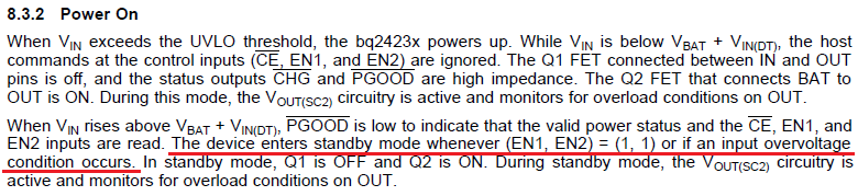

I read the following description(red part) and have a question.
I believe the device enters standby mode too if #CE is high level.
Is my understanding correct?

I believe the two modes are different and should not use the same "Standby" name. The datasheet will be updated.
To clarify, if EN1/EN2 are both high, the Q1 is OFF, Q2 is still on so that the battery can supplement the output needs. If EN1/EN2 are not both high but /CE is high, Q1 is ON but battery charging is disabled. Output can be powered either from input or from the battery.
