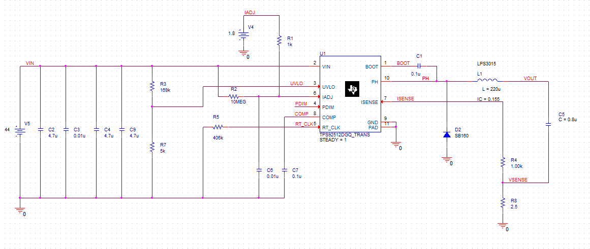

Hi!
I use the tps92512 to build a smps for traffic light.
You can see the design cocept here: https://e2e.ti.com/support/power_management/led_driver/f/192/t/416015
After calculating the proper component values i ran the simulation and all seemed to be perfect.
But, when i tried to build a prototype all my tps92512 chips were burned...
Can sb check the attached files to point me what it is going wrong???
