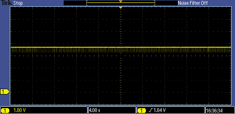

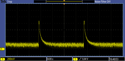

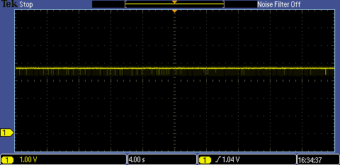

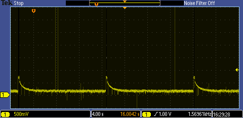

  • Standing the resistors on their side did not change the measurements. I'm setting up for some scope plots but what scale is Figure 15 using? Are the gaps on LBOOST the MPPT measurement times at 16 second intervals?
  • Here are some scope plots. Let me know if this is not what you were expecting.
    LBOOST
    VSTOR
    VBAT_OK
    VIN_DC

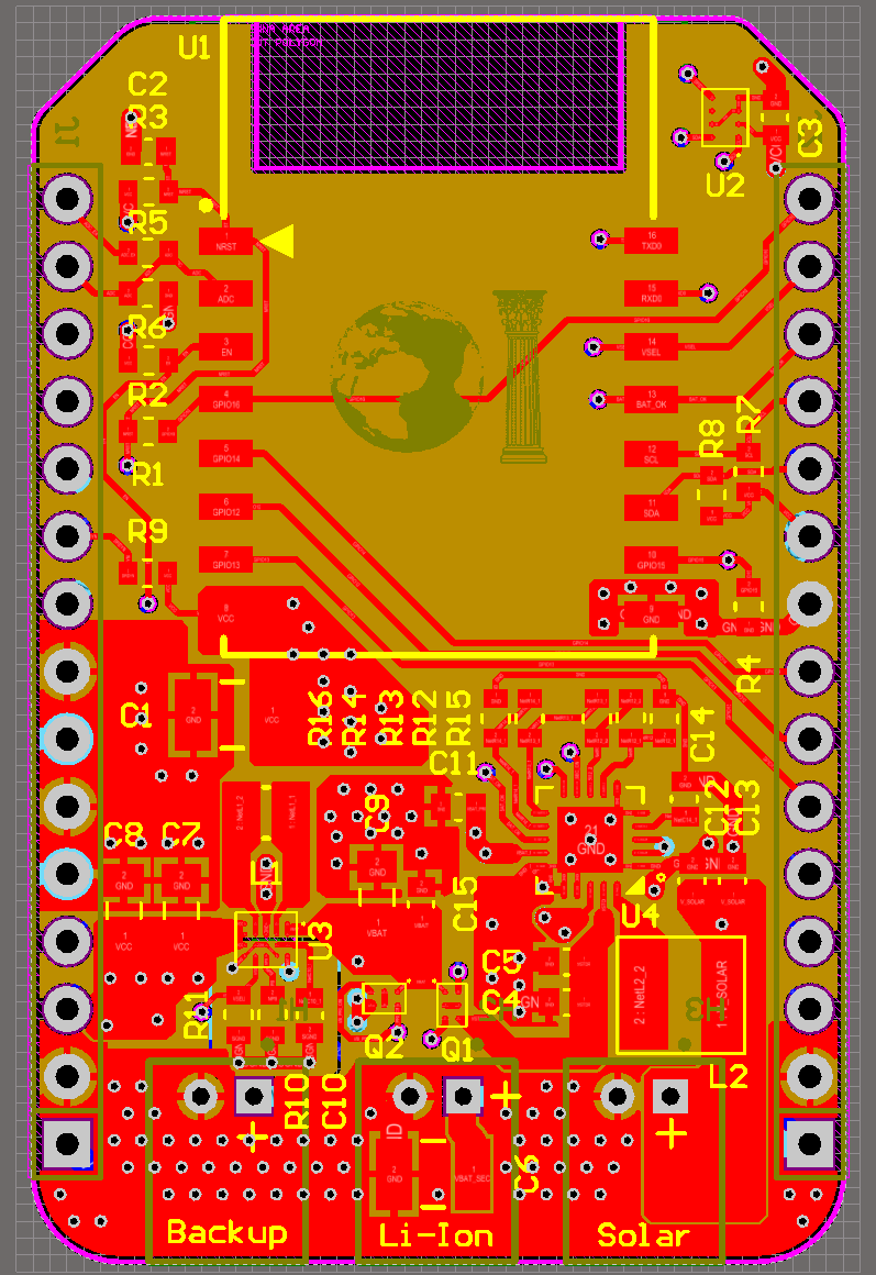

    We do have a 0.1uF bypass cap (C5) close to VSTOR, as well as a 4.7uF (C4). See the attached top side layout view for reference.
