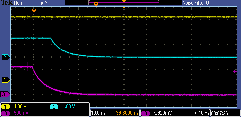

    In my capture, the 5V output by SYS are clearly shut down at the moment the PGOOD signal goes down, the caps start to get discharged at that moment.
    Here is a capture with a SW shut-down command that shows how the 5V starts to go down together with the PGOOD signal. VDDS_DDR t loses regulation before shutting down, and it actually shuts down 1.5ms before it should. I'm using BBB_SCH netnames to be 100% consistent.
    ch1 = PMIC_PGOOD (after U16)
    ch2 = VDDS_DDR
    ch3 = SYS_5V
    ch4 = VDD_CORE

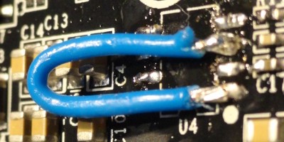

    We added a 220uF cap to SYS_5V that increases the stored energy by more than 100%. Now VDDS_DDR is able to shut down at the right time (10ms after PGOOD goes down). This is still with a SW shut down:
    Something similar happens with the sudden shut-down, but unfortunately the 3.3V outputs are not able to stay regulated because the UVP level is too low (3.5V). This may not be a very critical issue because losing the 3.3V regulation "shouldn't" damage the uP.
    Here you can see the same signals, with 220uF extra cap and with a sudden removal of the 5V instead of the SW shutdown.

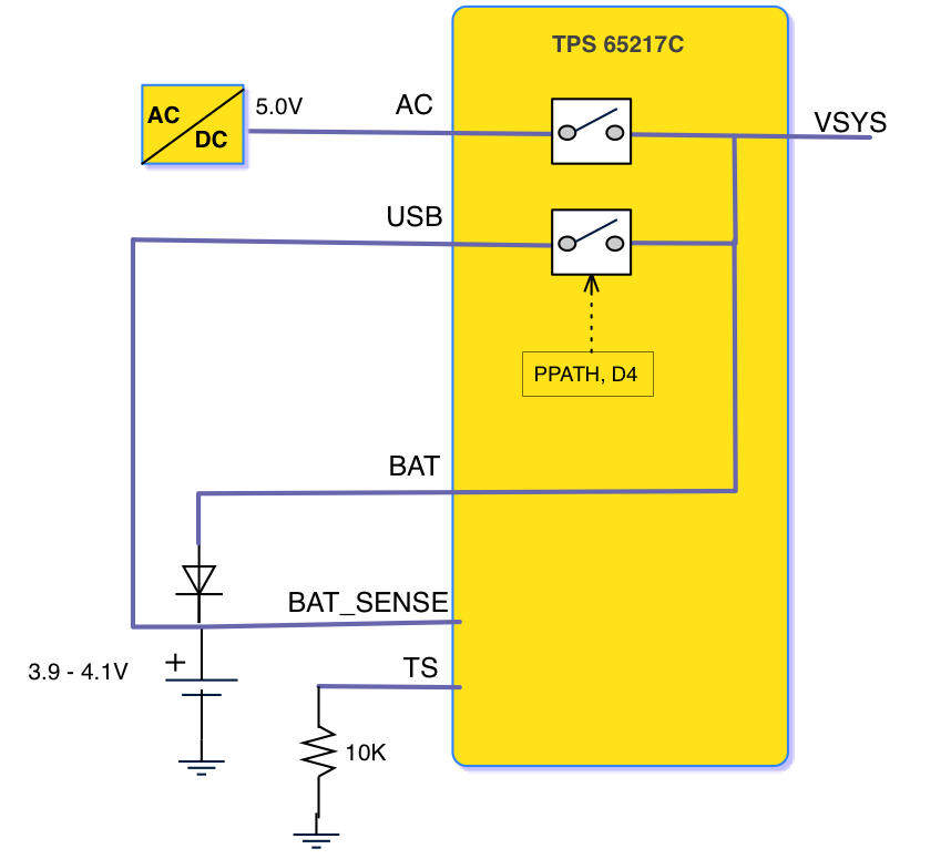

  • Hey Guys,
    The problem of using a LiIon battery to allow BeageBone boards to orderly shutdown is object of several posts here.
    In my particular case I just want to use the battery power to allow shutdown and disconnect the battery from the power path at the end of power down sequence to work around the problem of VSYS being kept with 4,1 V causing VDD_3V3A to set to around 0,8V.
    As I don't intend to run on battery nor on USB, I came up with this solution and I would like to have your thoughts in why it didn't work ....
    The whole idea is to connect the battery in the USB input of the PMIC (instead of BAT terminal) allowing battery power to be connected/disconnected using power path control bit D4 in the Power Path Control Register (PPATH). With this I can change the shutdown routine of the OS to disconnect the battery power from VSYS just at the end of the power off cycle, before issuing the POWER_EN Signal.
    As the battery still needs to be charged, my idea is to connect BAT SENSE to the battery (+) and connect BAT to BAT SENSE via a low Vf diode in order to prevent the battery from supplying the original power path. It should work because the charging cycle tests the battery presence sending a small current to it and sensing the voltage (via BAT SENSE I suppose). Naturally TS is supposed to be connect do a 10K resistor to ground.
    However, it didn't work! PMIC just didn't turn on when AC input is connect to a suitable 5V power supply.
    Does someone can explain why not?
    Best regards

  • Angelo,
    I will answer the other Thread (e2e.ti.com/.../2272252) because it is independent of this question and may not have the same solution.
