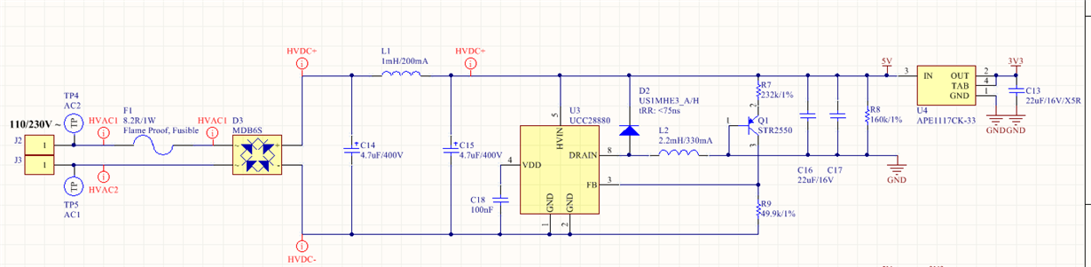

I have made one PCB to get AC110~220V to DC5V/100mA by using UCC28880.
Here is my schematic:
The 5V is OK, but the noise(sound) is annoying. I think it's coming from L2.
I don't know what's going on this circuit, Could any one tell me?
