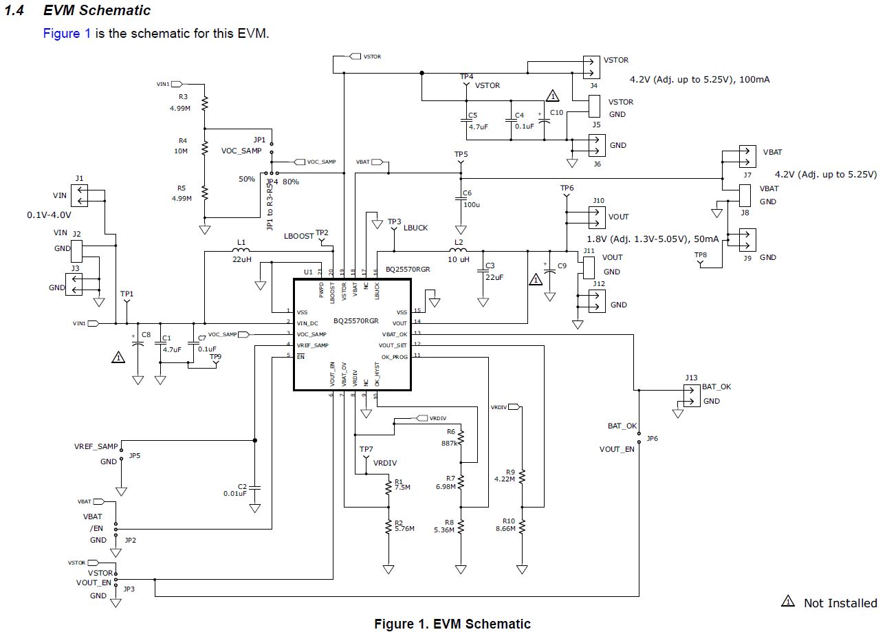

On the BQ25570 evaluation module schematic there are 7 resistors are used to set levels for the nano-power management levels.
OK_HYST and OK_PROG share the same voltage divider.
Could VOUT_SET and VBAT_OV also be part of the same chain?
