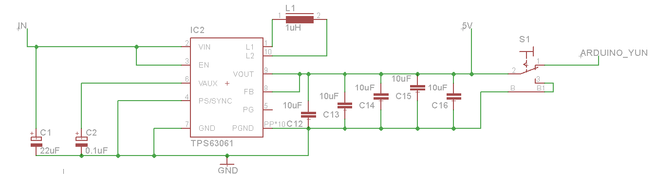

Hello everybody,
I am building a circuit using TPS63061, but I have found a problem with it,the schematic is this:
I have found a problem, I feed the TPS63061 and I have nothing connected to Vout then I connect a uC to Vout, it works fine, but If I feed the TPS63061 and I have already connected the uC, then It doesn't work fine, Vout returns 0.5V more or less. By the way, the TPS63061 is connected by default to a 3.3v regulator and several IC, only it has problem when I connect a external uC. The Vin is shared with anothers iC. I can't find the problem.
I am very worried about this topic.
Thanks a lot.
