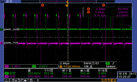

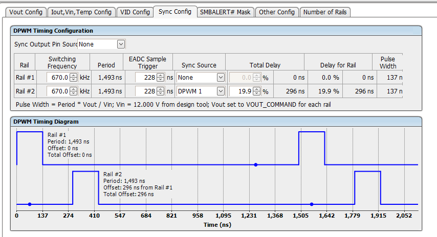

I am working on the UCD9222 device with two UCD7242 to output two voltage rails(Cvdd and 1v0). Generally speaking, it work ok except the pwm freq is not the same as the one set in the configure file(xml file).
In the xml file, two rails set pwm freq for 670Khz.
but measure from the oscilloscope, it is only about 593khz.
Question: why the pwm freq is not the same as the one set in the configure file? About factor will impact this case?

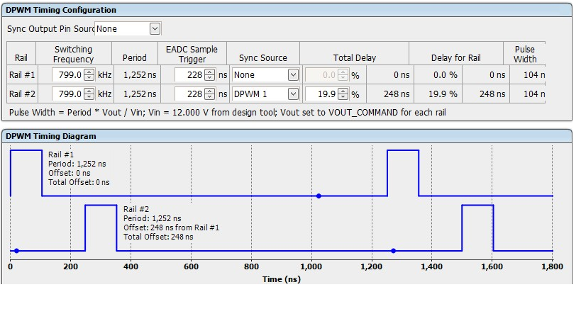

  • Hi zhiyuan;
    (1)the switching freq can change base on the new pwm freq config in xml file.
    I set switching freq= 799khz,but it only output about 670khz freq.
    see below for detail:
    the new freq get from the oscilloscope:

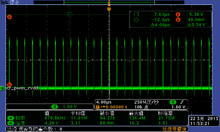

    BTW. an interesting finding for the PWM freq. When remove both the  UCD7242 in the PCB, B's UCD9222 can output the freq what we wanted. As no UCD7242 in the circuit now, the duty for this PWM is not correct but it is ok for the PWM freq. see below for detail.
    we retest it in the product A(also remove both UCD7242), but the PWM freq is still ok.
    it seems that the UCD7242 in product B bring impact to the UCD9222's PWM freq output. Amazing!!
