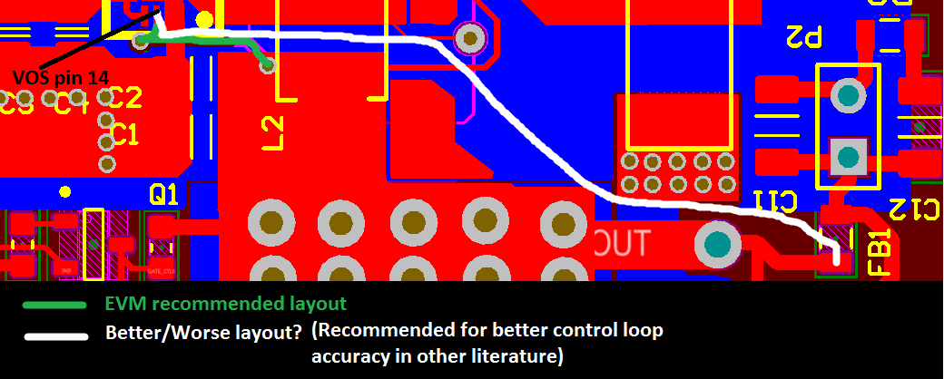

1. The VOS line in the EVM (SLVU437A) is routed from the VOS pin 14 through a via to the bottom layer, then through another via to the top layer and finally reaching VOUT just at the point where the output capacitors C3 and C4 are connected together with the inductor L2. This is not exactly the point where the load will be connected, which is the output connector J9 in the EVM. In my layout I have it routed in the same manner, not connecting the VOS pin to the point where the load will be connected but rather to exactly in the output capacitors (C2, C1) following what is stated in the datasheet and EVM. In other designs the pin that senses the voltage should be connected to the point where the load will be connected for the controller to be able to regulate the voltage at the point of interest. My question is: is the connection in the EVM good for all cases in this chip? Are there any assumptions made when making this connection at the output capacitors rather than the load?  Please refer to image VOS ping routing.png

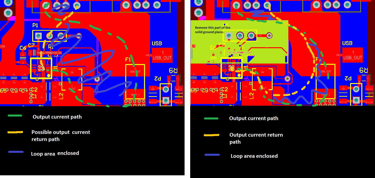

2. Loop Area for high frequency load currents: due to space/position restrictios in my application, the high frequency output load current needs to make a 90° turn near the IC.  Since the radiated energy is proportional to loop area formed by the load current (as is also stated in the TPS62133 datasheet SLVSAG7C) I am not completely sure a solid ground plane would be the best low impedance/EMI Absorbing path to be used, since it would enclose a relatively large area. Instead, I was considering to route this return path just above the output current path, so that the loop area is decreased to a minimum. Would this be a better approach?  or should the solid ground plane still stand despite the possible loop area?  Under the understand that high frequency signals will choose the lowest impedance return path, this path would be just below the output current path, in which case the solid ground plane would be unnecessary (at least for high frequency signals). The best decision is not clear for me, so is there any recommendation?  Please refer to image Return Path.png
I would greatly appreciate any feedback on this two inputs. The board was designed following as close as possible (and sometimes exactly) to the recommendations from datasheet and EVM, so I expect a first time working board within specifications.
  • Thanks for reading our reference documentation before doing your PCB layout. I would also note that you can order the EVM to get a PCB with no R&D effort on your part to experiment with your circuit.
    Yes, you should route VOS as shortly as possible to the output cap. It is not a remote sense input as in other devices. The FB pin is responsible for regulating the voltage setpoint.
    Your second question is not perfectly clear. I'll note that the inductor and output cap handle the AC currents in the output which is the critical loop to keep small. It should just be DC current going to your load which is much less dangerous to deal with.
  • Since for my application the position of the output connector is different from the EVM, should I allow the output current return path be through the solid ground plane or would it be better to route it only under the intender output current output direction in order to reduce the loop area?
    By your comment on the inductor and capacitor, I would guess that the ground plane that connects the output and the regulator would serve only as return path for the DC current going to the load which is much less dangerous, as you said. So, that makes me think there is no reason for removing the ground plane to reduce loop area since anyways the current that would flow through that loop would be basically DC. Is this correct?  Thanks, sorry for not being clear from the beginning, I hope I am now! :)
  • Yes, ground planes are good to return DC currents. You should in general, have a ground plane.
  • Hi Chris, thanks for your feedback. I had several questions and points behind which I would like to treat:
    - You mentioned the VOS should be placed as close as possible to the VOUT voltage and the FB pin is in charge of the regulation. But in the TPS62133, which is a fixed 5V (TPS62133RGTR) the FB pin is grounded (as is recommended in the datasheet, page 3, pin functions). On the other hand, the VOS line is the "voltage sense in and connection for control loop circuitry.
    I understand and will follow your indication if you tell me that VOS line should be connected as close as possible to VOUT, you are the TI guy in the end and I am using an IC  you designed so I will stick to your indication, I just want to point out some reasons that did not logically lead to the answer you gave me, and in the end I am responsible for the product.
    - Despite of the point above, I of course routed the VOS signal in my PCB as you told me and as all the documentation explains and show. The voltage regulation in the IC is really good at least in terms of noise at low (50mA) and high (2.5A) currents, with less than 30mV pk-pk voltage ripple across that wide range (I have not yet measured step response).
    - Regardind efficiency of the final design, I am at very good efficiencies  at high currents but not doing so well at low currents, which is a must in my application. In this sense, I want to ask you: Is there a private channel through which I can communicate with you? I would like to share some sensitive design files to have your feedback.
    Thansk for your feedback.
  • Yes, for the fixed output voltage versions, the VOS pin does both roles and must be connected close to the IC.

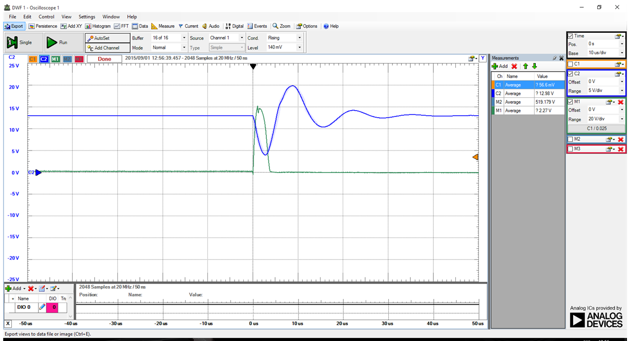

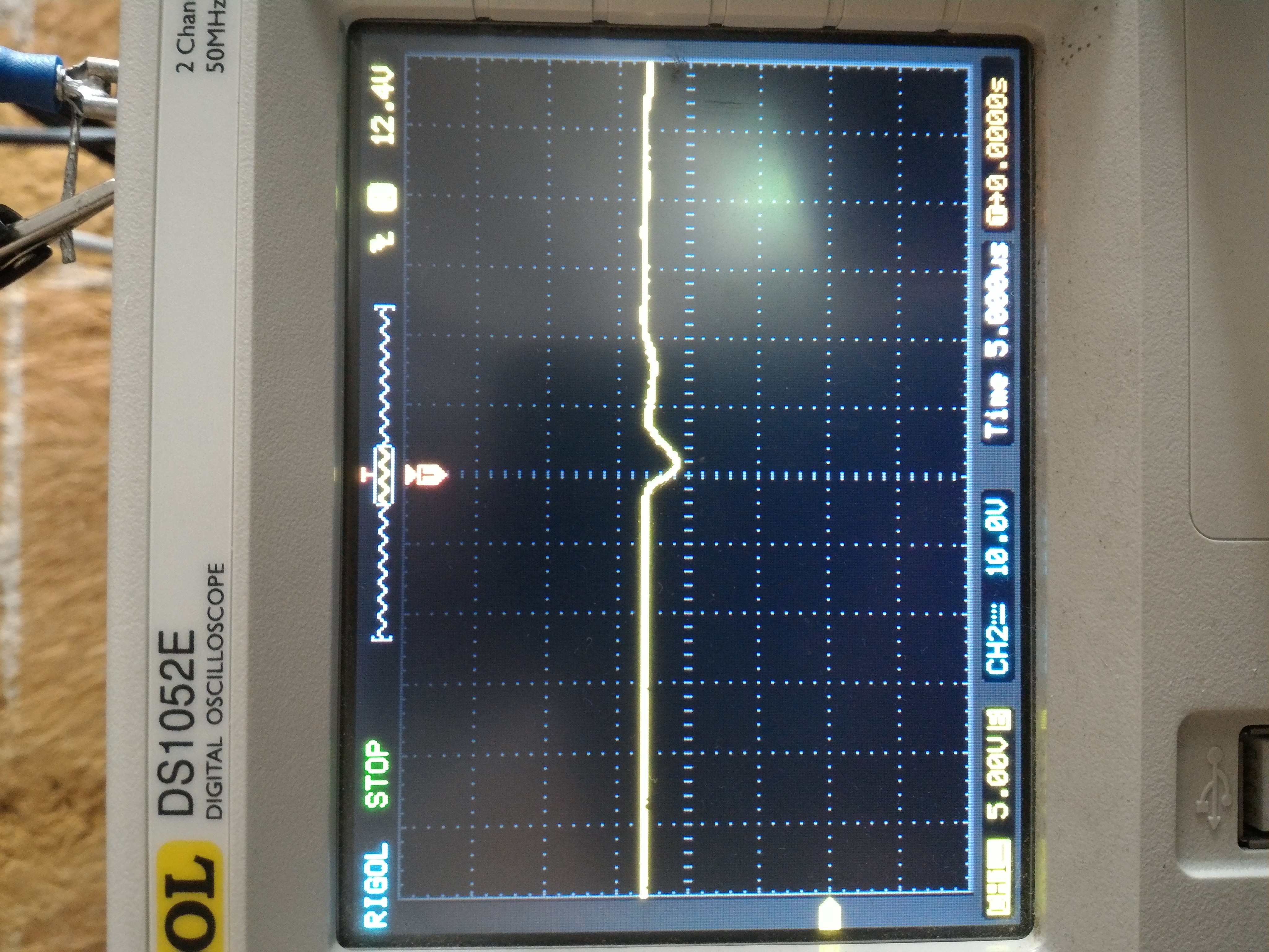

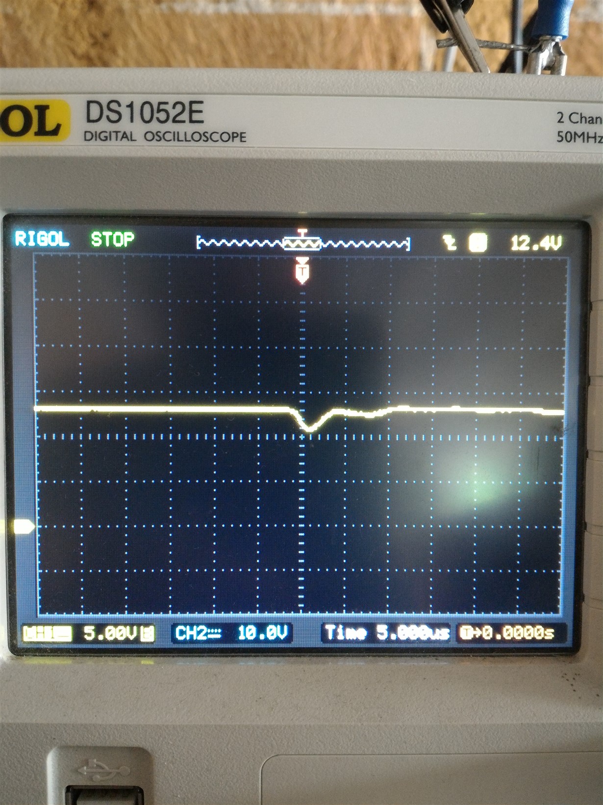

    Related to my previous post on output protection for the TPS62133, I have choosen the TPS2592BA. The system I am designing has another 12V, 5A output connected to the same 12V, 12Ah SLA AGM battery which supplies the TPS62133. This other output has also an output protection device, the TPS25910.
    When making some tests on this last device in the actual system, making a hard short circuit on the 12V output (Output ON, then short circuit) I have measured that the voltage input, which is the battery, swings due to the high short circuit current. This produces a swing in the input voltage of about 15V, which makes the input voltage reach approximately 20V. This voltage will be present to the input of the TPS62133, and, since is beyond the recommended maximum input voltage (17V) and just exactly at the Absolute Maximum Input Voltage (20V) it has raised concerns. Beyond that, during one short circuit test, I was able to damage one of the TPS62133.
    I am thinking about using a TVS to suppres those voltage spikes that can be generated during a short circuit event, or any other event that can produce suck spikes in the input voltage. The question is, what would be the recommended maximum clamping voltage for the TVS to protect the TPS62133? Should it be under 17V or 20V?
    If I had no other constraints I would obviously use one with Vclamp<=17V, but the issue is the following. Since the battery needs to be recharged constantly, the maximum voltage it reaches during recharge is 14.7V. So the TVS must have a reverse working voltage >14.7V. Normaly the TVS diodes clamping voltage is around 40-60% above the reverse working voltage, so I have found options that either: have a reverse working voltage over 14.7V but a clampling voltage well over 17V (19-26V) or have a clamping voltage below 17V, but a useless reverse working voltage (11V - 14V), taking into account not only nominal specifications, but minimum and maximums.
    Choosing a TVS with a maximum clamping voltage below 20V might aliviate this situation, but I would be outside the recommended operating conditions.
    What do you recommend to do? Would it be OK to use a TVS with a  17V<Vclamp<20V?  I am attaching the waveform of the battery voltage. You can see there the duration of the event is in the order of 5-7us. Would this immediately/slowly damage the TPS62133?
    Thanks again for your support.

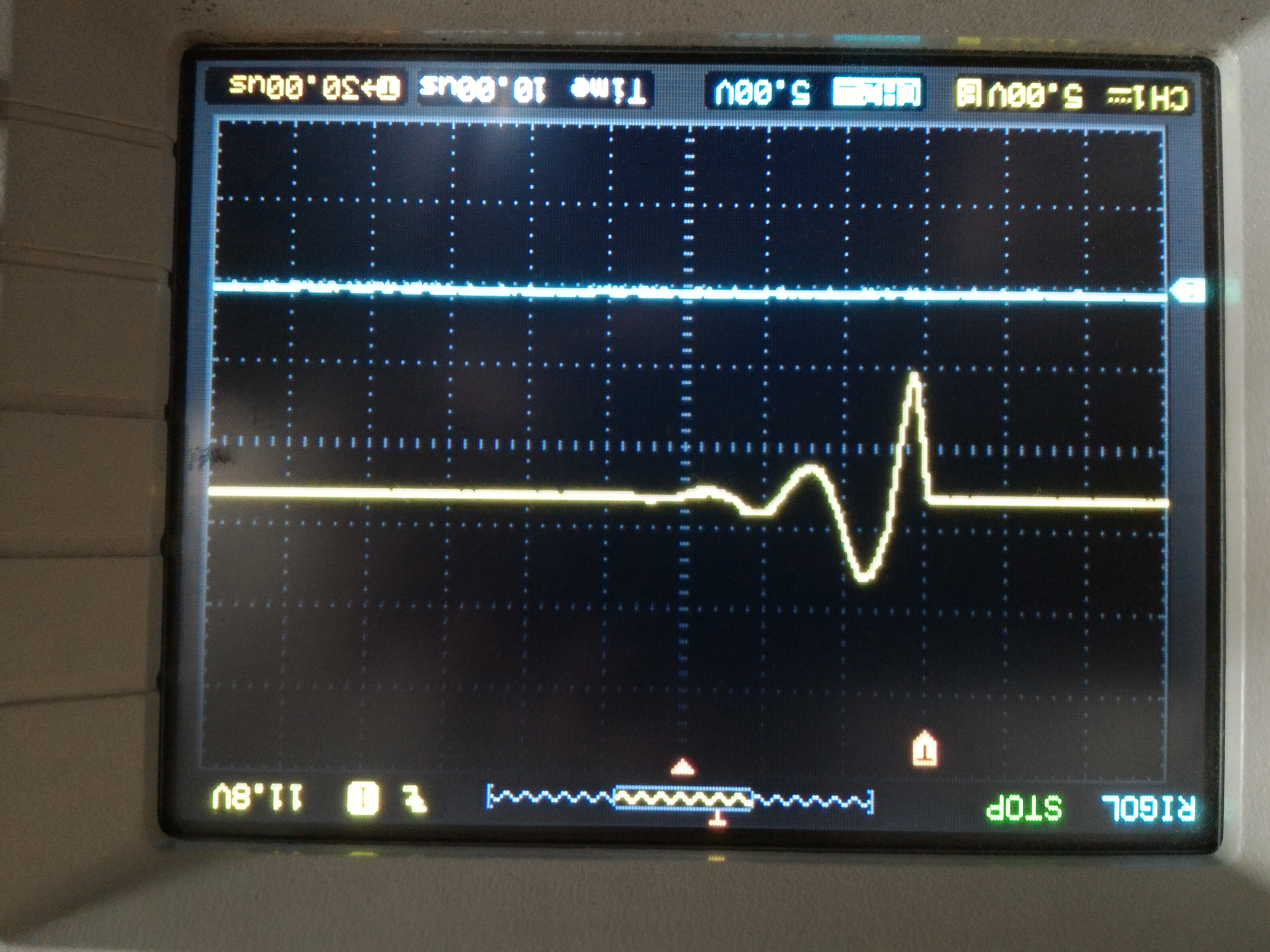

    The Blue Waveform is the input voltage from the battery during the shorcircuit event, you can see that its around 13V before and after the short. The green waveform is the current during the short circuit at the other 12V output (it reaches almost 60A). I will send via private message the updated schematic for clarity.
  • Yes, you can clamp above 17V for your situation. I would ask you to measure the Vin right at the IC's pins with a scope to see the real waveform.
    More input capacitance is another possible solution. As well, a series element like a small resistor or small inductor might help separate the two nodes. We also have this reference design: http://www.ti.com/tool/PMP9757

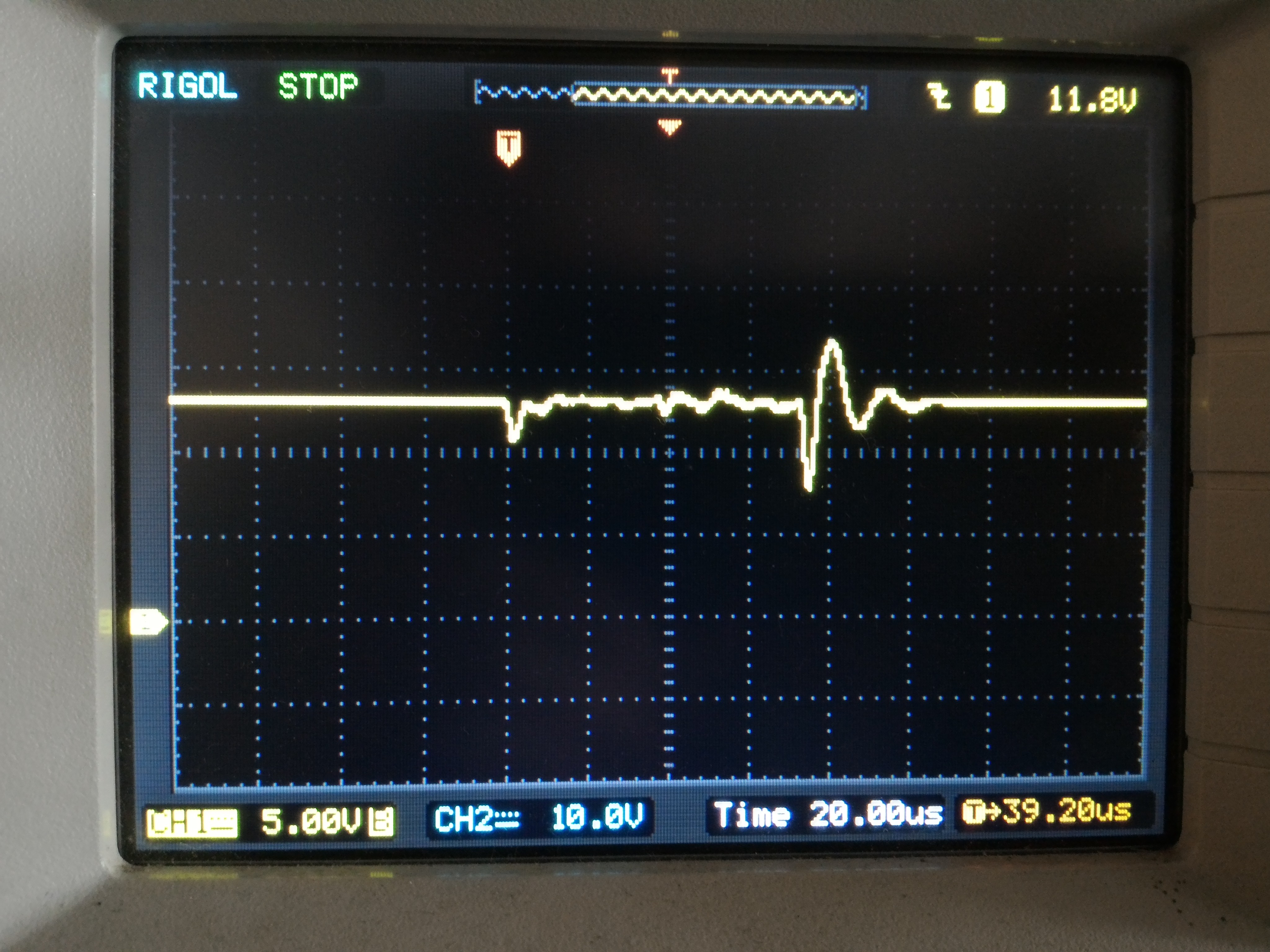

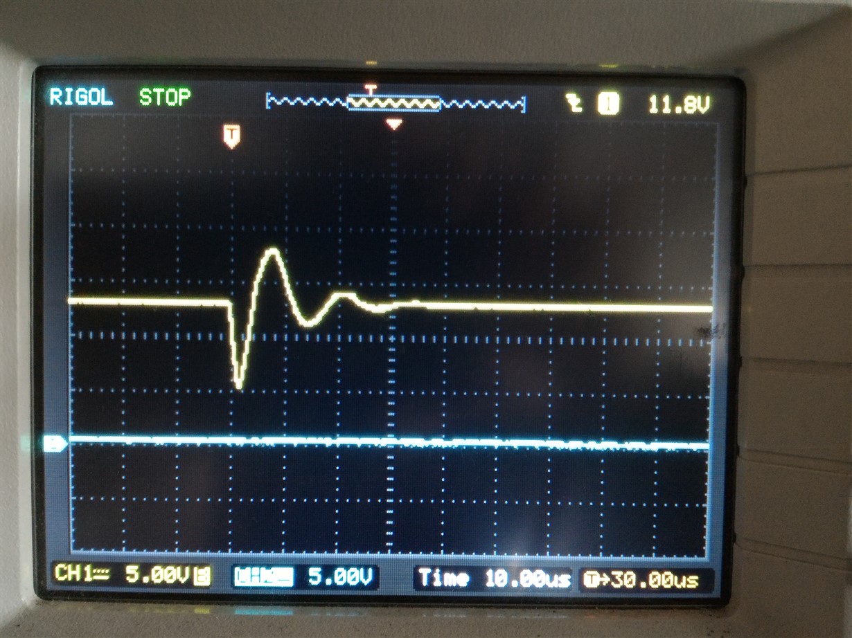

  • Thanks for your response. I am attaching some pictures of the waveform right at the IC's pins.
    Adding more capacitance did have some marginal impact, reducing the voltage spike around 500mV on averega, but that is not enough. Thanks for the reference to the appnote. I already went through it, but I need to analyze it more in depth.
