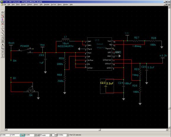

    With less than 4V input, Vout comes up to the assigned 5.5V but the LDO has no output. PGood is low. LDOenable is tied to Vbatt.
    See attached schematic as built.
    Vbatt has some ripple reflected back from the switcher. Load is less than 100mA
  • It seems OK with your schematic, except for 10uF input Cin is recommended.

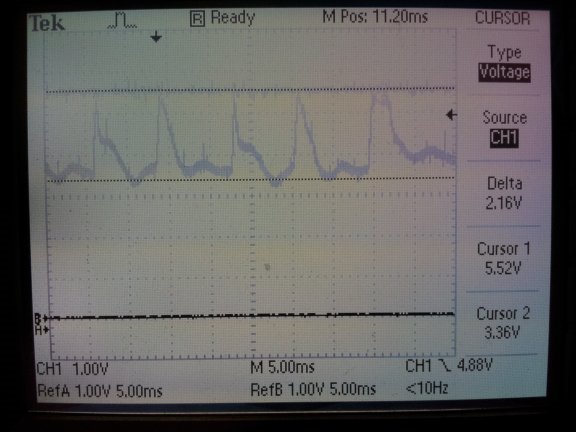

  • This is Vout (5.5V) during a heavy load event (60Hz audio)
    It does fall below 3.3V
    The LDO is powered by this 5.5V output.
    The LDO drops out completely (zero volts) during this event.
    How can I  maintain 3.3V?  I can tolerate sag but not total loss of 3.3V
  • Hi Bruce,
    From the waveform we can find that Vout has already drops below 3.3V, which is the output level of LDO. I think the problem is that the load is too heavy, in this case, LDO won't work normally because LDO's input has already below the target output.
    I suggest to connect the LDO directly to the input voltage soure, not to the output of the boost. Or change for another Boost with larger current limit. what's your application and spec of the circuit, so that we can provide you other options.

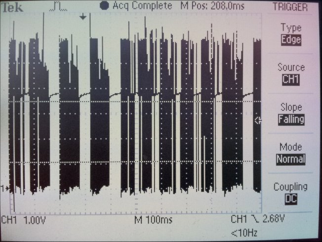

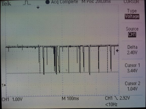

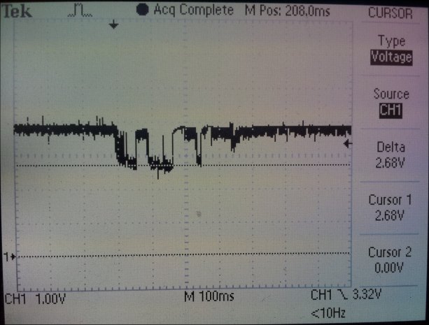

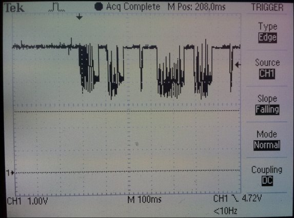

  • LDOen is indeed connected to Vin
    The problem does not exist with fresh batteries or a stable Vin supply
    Vin (battery)
    Vboost (5.5V)
    SW
    Vldo (3.3v)
  • It's helpful to get the waveforms of Vin.
    I think it's the internal logic that turns the LDO off.
    LDOEN is connected to Vin while LDOIN is connected to Vout. Vin drops below 2.6V when load is heavy. The internal EN logic of LDO is 0.8*LDOIN, which is below EN threshold. I think it should be the problem. Please connected the LDOEN to a seperated voltage supply as mentioned before or connceted it to LDOIN (Vout) to see if it can hlep.
