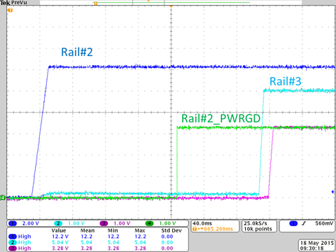

My customer has problem about turn on sequence.
Both ON/OFF config of Rail#2 and Rail#3 are 0x02 (Auto Enable), and Rail#3 will be turned on after 100ms (Rail#2 PWR_GOOD).
And there is a extra long delay(about 160ms) on Rail#2, it makes Rail#3 delay more.
But, Rail#2 rises to PWR_GOOD level at very beginning. I don't know where the extra long delay come from.
If we disable Fault log for every Rails, the sequence is normal, there is no extra delay on Rail#2.
How does it happen? Below is the waveform.
