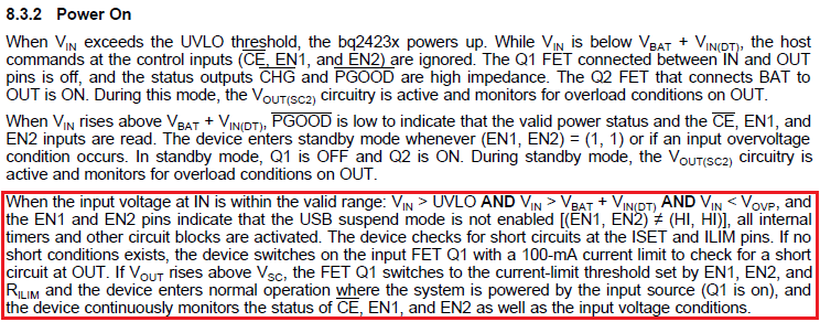

Hi Team,
I would like to ask about the following.
1) How does bq24230 operate if Vin(supply) is more than OVP threshold during charging?
    I would like to know the state of Q1, Q2, safety timer and #CHG pin.
2) How does bq24230 operate if Vin(supply) is less than UVLO threshold or VBAT+VIN(DT) during charging?
Your support would be appreciated.
