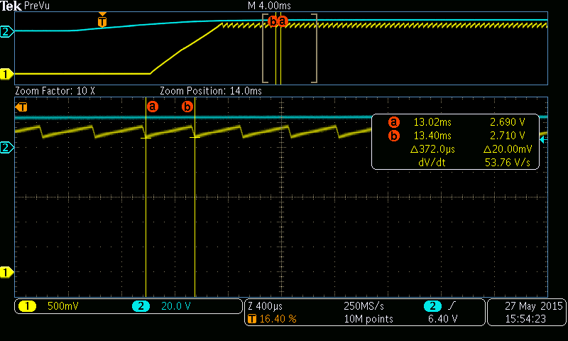

We have been having some spurious failures with the LMZ35003 which I am trying to understand. There is no
possibility that the output load voltage has been shorted, and when the IC is replaced everything else on
our hardware appears to be fine.
The IC is configured to convert 48V to 8V2, with no current limiting - we are copying the reference
schematic in Figure 25 of the datasheet (SNVS988 – JULY 2013)
R_RT = 365k
R_SET = 93.1k
R_UVLO1 = 174k
R_UVLO2 = 20k
Capacitors as required.
The failures have occured when operating from a supply of 48V and 24V.
The symptoms of the failure are that the output voltage only goes up to 2.9V instead of (8.2) - see waveform.
Thermal shot is also attached - it appears that the IC is getting hot in one region near pin 1.
Has anyone seen anything like this before or able to give any insight into solving the problem?
Thanks for any help.
