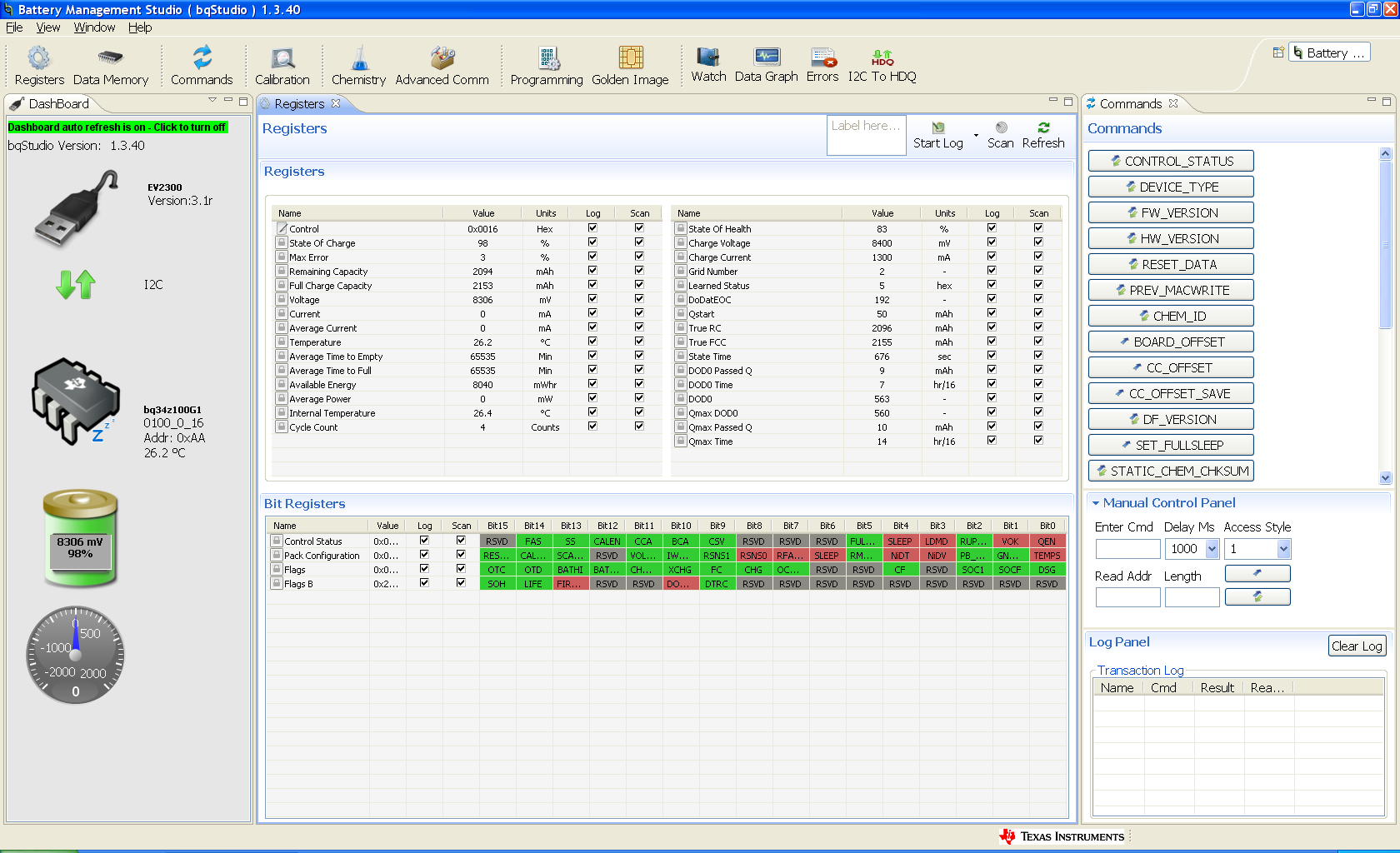

  • The command menu is available. cannot find the manufacturer access register. perhaps you mean the control register?
  • Andreas,
    I am sorry fro the confusion. I was speaking in general for our gauging devices. The Control field on the bq34z100 is the same as the Manufacturer Access field on other gauges. In addition, the bq34z100 does not provide FET control, so there is no FET control command. Your screen shot shows that IT is already enabled. What device are you using to control the FETs? You will have to command it to turn them on.

  • Hi Thomas, I am using EV2300. Correct the IT command is now enabled - my discharge circuit was different to the one suggested in BQEasy I was trying to control VBat instead of ground.

    Update Status has changed successfully to 5%.
    QEN & FC bit is still set to 1
    VOK is now set to 0
    Qmax was set to a new value
    I quess I continue to the next step.
    How do i correct though the Difference in Max Error Limit?
  • The Max Error Limit is a parameter that sets the Max Err threshold where the Conditioning Flag is set. The gauge does not change this parameter. You can check the state on MaxErr on the Registers screen. It looks like your optimization cycle is progressing normally.
