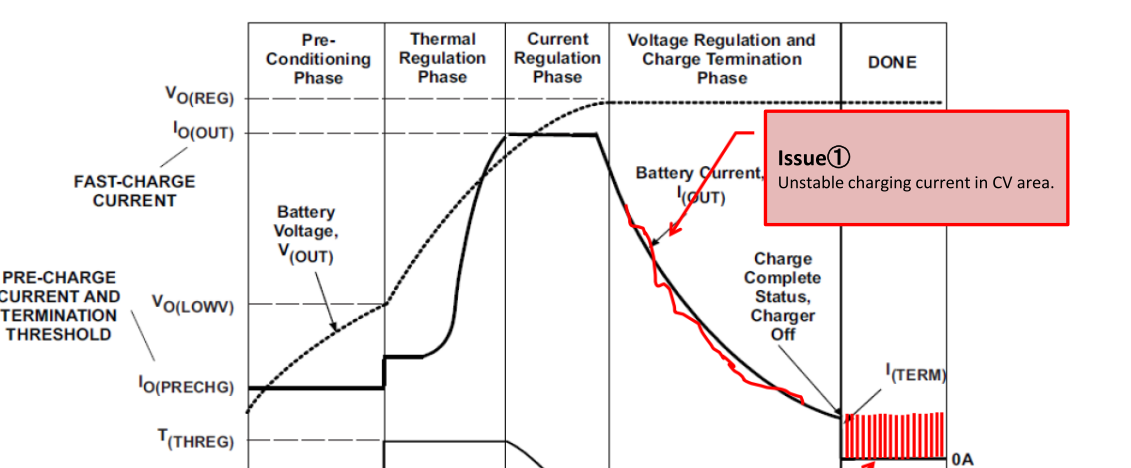

I have got a question about the charging current of bq25101H from the customer.
Can you check the attached waveform and customer circuit?
bq25101H.zip
Customer is measured in terms of ISET voltage.
Could you tell me advice about the cause of charge current .
Does this Issue is related additional circuit of ISET?
Yusuke / Japan Disty

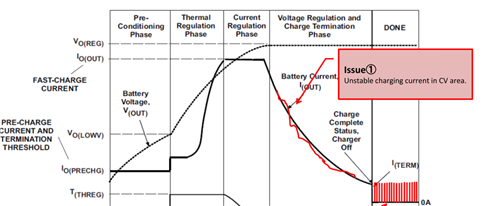

  • Hi Wenjia-san,
    Customer is reading the voltage of ISET pin in the logger. (IST pin- logger line is about 1m.)
    Customer have been translated the measured voltage to the charging current.
    Could you advice about the only issue①.
    Customer added the RC circuit. However, the problem did not resolve.

  • 1. The RC circuit is used to add the compensation to ISET circuit at low current due to the parasitic capacitance at this pin.
    2. The RC value was calculated based on design simulation.
    3. I think this might be caused by the line resistance between the OUT pin of the device and the real battery. Because of the voltage drop over the line, the OUT pin voltage is higher than the real battery so the IC will terminate charging even if the real battery voltage is below 4.2V. Once the charging is terminated, the current drops to zero so the voltage drop is also reduced to zero. Now without the voltage drop, OUT pin voltage is the same as the real battery so the charging is started again
    As you mentioned that customer was using the same battery, I would expect it is the 4.35V battery. Bq25101 is a 4.2V charger so when the battery voltage is close to 4.2V, the bq25101 will stop charging but it is not yet in CV for the 4.35V battery. Therefore bq25101 didn't have this issue.
    Can customer measure the line resistance between OUT pin and the real battery? Can they try floating TS and measure the current again?
    Wenjia
