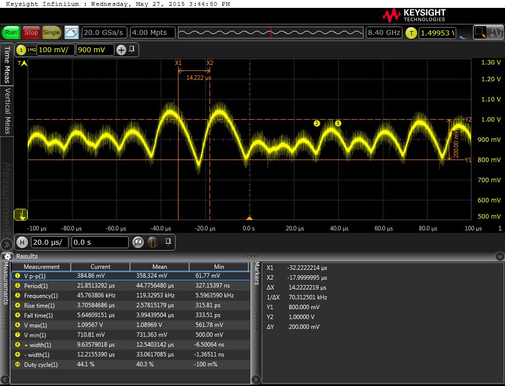

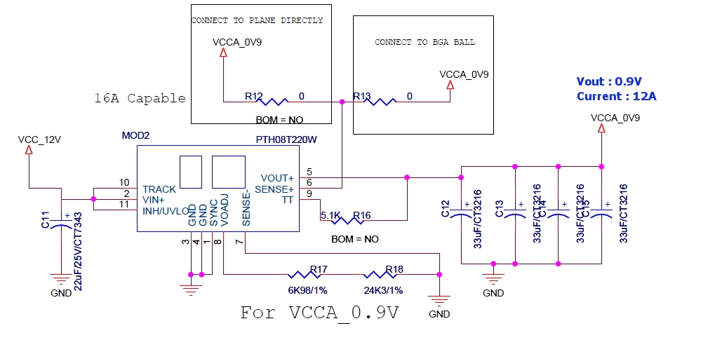

i am using  PTH08T220WA and Vin = 12V / Vout = 0.9
If the output vout to 0.9V, Ripple of 61.77mV occurs.(Measured waveform reference.)
What causes this problem to occur? What causes this problem to occur?
Thank you.
Schematic)

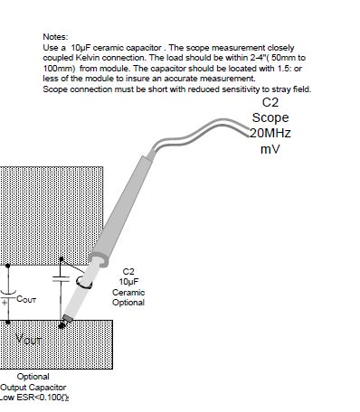

     PTH08T220WAx  requires a  minimum output capacitance of 220uf polarized . Your  70kHZ measured frequency is not related to the PTH08T220WAx switching ripple frequency of 300kHZ or 3.3usec period..
    The best  ripple  measure method   is use a close coupled scope probe  across a 10-22uF ceramic capacitor . The scope bandwidth should be 20MHZ  to eliminate "E"  stray field scope probe .
