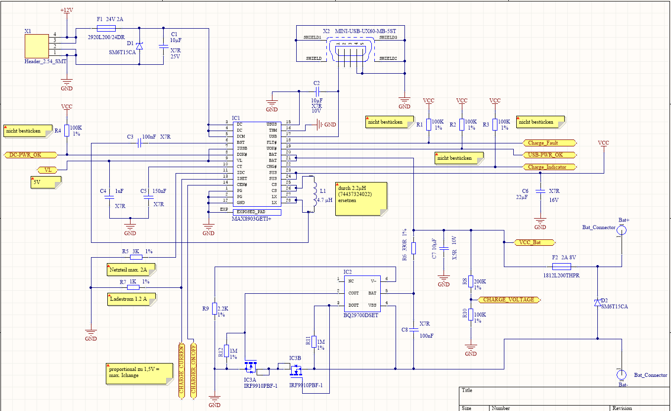

I am using the TPS63020 Buck-Boost-Converter for powering LEDs which are controlled with FAN5624 constant current LED-Driver.
Power source is Li+ battery so Vin is 2,6-4,2 V and Vout is 3,3V.
When the Li+ battery is fully chargend 4,2V then the current is 1,6A and the IC TPS63020 is round about 45°C.
But if the battery drops down to 3,6 V current is going up to 1,8 A and IC is getting hotter 55°C this continue until 2,8V 2,2A IC is now 90°C hot and Vout is switching but is still near 3,3V. When I cool down the IC with ICE-Spray Vout is 3,3V and there is no switching.
Why is the IC getting that hot?
Why is the current rising when the Li+ Voltage drops and the IC is operating in Step-Up?
What can I do to avoid that high Temperature?
  • With a constant output power, the input current must increase if the input voltage is lowered. This is the conservation of power.
    As shown in the D/S figure 11, efficiency drops with decreasing input voltage. Thus, the temp goes up.
    You are operating the device very near its maximum power level. I recommend the newer TPS630250 which is more efficient and a little bit higher power.

    Another problem which I do have with using BQ29700DSET as cut off guard for the Li+ battery voltage at 2,8V is that there are to scenarios which are unacceptable for my circuit:
    1. When the Li+ battery has low charge e.g. 3V the inrush current at power on is that high that Voltage of Li+ battery drop for a small period of time under 2,8V (I saw it on scope it goes down to 0.9V) and
    the BQ29700DSET switches off. Because of that I can't use the whole capacity of the Li+ battery. What can I do? I thought a about an extended soft-start could these be a right solution and if yes how I can add it to TPS630250 or TPS63020?
    2. When the Li+ battery reaches the threshold voltage 2,8V of BQ29700DSET it switches off as aspected but then the battery voltage recovers without load above 2,8V and I can switch on the device again these I can repeat endlessly.
      But my goal is that once the battery reach 2,8V BQ29700DSET switch off an only switch on again when the battery was charging about 2,8V and not because of voltage rising with no load.
      Is there any possibility to do that with BQ29700DSET?

    Also in the datasheet of TPS63020 it is recommenden that R2 in the FB voltage divider should be in the range of 200K is my FB voltage divider at schematic R13 1M , R14 178K for 3,3 Vout okay or should I calculate it again?
