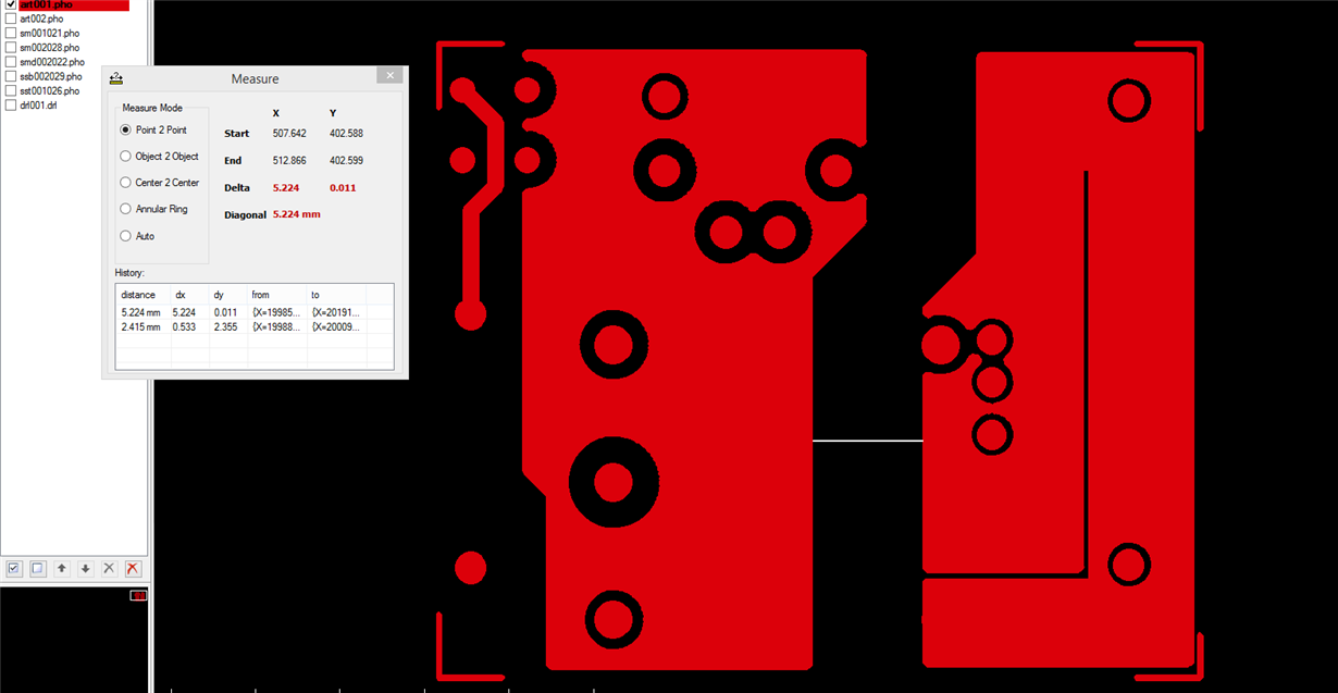

The below photo belongs to PMP4447. According to the gerber files, the isolation space is 5.224 mm. Isn't it a requirement to have 8 mm isolation according to IEC60950?
Do you think it may cause any problem if 0.8 mm standard FR4 board is used instead of 1.6 mm on such PSU?
