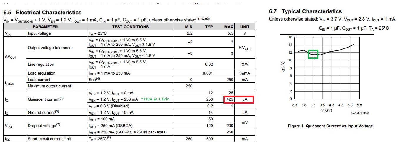

Questions. In low-power mode the quiescent current is too high at 425uA, (looking at 6.5 table). But it looks ok (11uA) if you look at Figure1. Can you clarify this?

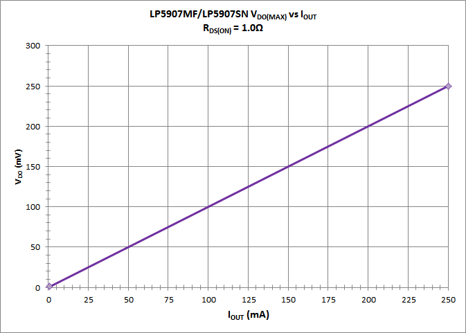

  •  Q1a : Vdrop-out ?
    A1a :Estimated to be 1mV(max)

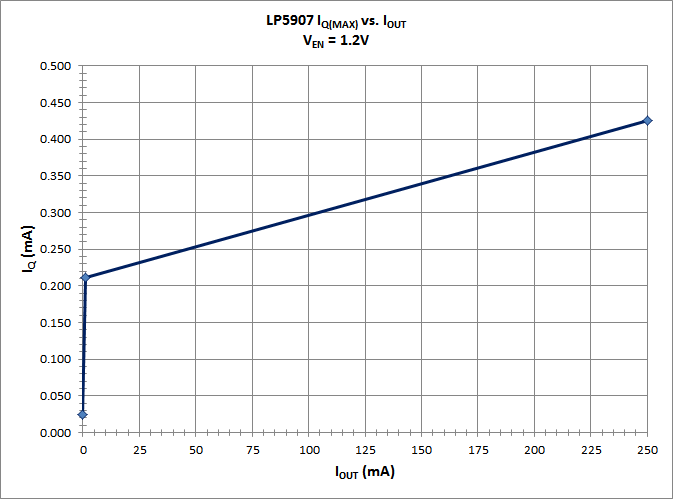

    Q1b: Quiescent current ?
    A1b: Estimated to be 27uA(max) (Edit : should be 212uA(max) see correction below)
    Q2: Is operating at Vin=5.5V ok?
    A2: As long as device dissipation of 547 mW and Theta(ja) does not push the junction temperature too high, no problem.
    (Edit... to prevent possible confusion the 'Iq vs Iout' chart has been removed ... see new chart below)
    My apologies, but I need to make a correction to my my reply to the Quiescent current question.
    In my haste presumed that the que current slope is linear across the load current range.
    It is NOT. The Iout=0mA is a unique case.
    Limited bench testing has confirmed the knee is where Iout is approx 1mA.
    As such I have revised my estimated max Quiescent current at Iout=1mA to be 212uA(max).
