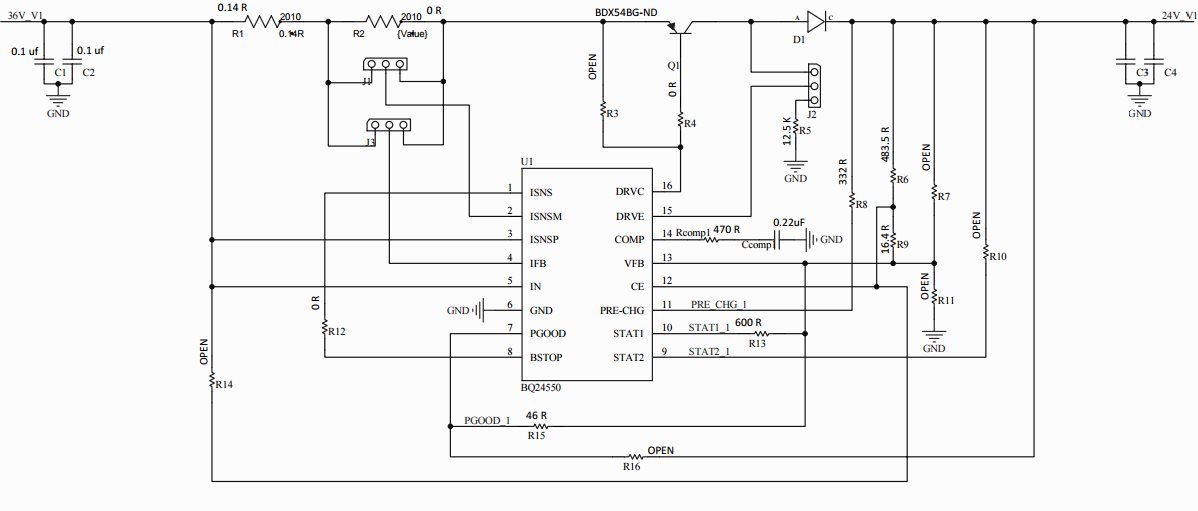

bq24450 interface with Microcontroller
Other Parts Discussed in Thread: BQ24450
Hello, I am design a smart battery charger with BQ24450. Charger is designed to charge 24V LC-R064R5P battery pack with an input of 36V. Please check the schematics below, further i need a suggestion is it possible that i connect STAT and PGOOD pnis with a 5V microcontroller? These pins are already connected to power lines via resistors so how can i interface? Please suggest. Thanks in advance.
