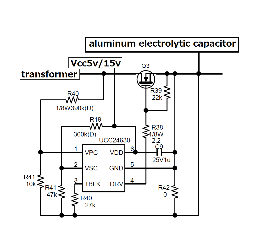

Would you mind if we ask about the high current on primary-side FET on synchronous rectification using UCC24630?
<Our recognition>
When the operation of the power supply switches from CDM operation to CCM, the high current flows the primary side FET.
We guess that turn-off delays at the secondary side FET caused it.
In this moment, due to turn-off delays at the secondary side, the primary FET and the secondary FET switch ON at the same time.
So, is our recognition correct?

  • Billy-san
    My customer showed a schematic around UCC24630.
    I will attach it.
    Could you understand the cause of the failure in this schematic?
  • Without the input voltage range and turns ratio, I'm not sure what the value of R40 should be, but the ratios seem reasonable so I expect that the issue is that the primary side on time is increasing by more than 600ns in one cycle which is causing cross conduction.
    Billy
  • Billy-san
    I'm sorry to ask you many times.
    This power solution type is Fly-back structure.
    The transformer turns ratio is 65 : 3.
    Minimum Vin=90Vac.
    We heard from our customer that the primary side FET has broken when a high current flows into it at Vin = 90Vac.
    We recognize that it is not enough information to , but if you have any idea to identify the cause of it, could you let us know?
    Best Regards.
    Nagai
  • Hey Nagai,
    See page 17 of the datasheet, section 8.3.2.
    If the reflected ring voltage exceeds 85% of the minimum bulk voltage for > Tvpc_blk, the controller interprets this as a primary on time, and at the end of this misinterprted 'on-time' it gates on the SR. This can cause shoot-through if the main FET turns on again at the same time.
    With the turns ratio in the design, assuming the minimum bulk voltage @ 90Vac is ~ 80Vdc, and assuming from the schematic that the design is 5V out (and not 15Vout), this gives a reflected voltage of 107.5V, which is well above the assumed 80V minimum.
    I recommend changing the transformer turns ratio so that the reflected votlage is < or = the bulk capactior minimum DC voltage, probably 70-80Vdc @ 90Vac as mentioned.
    Hope this helps.
    Thanks, Billy
  • Billy-sanYour answer was very helpful to me.Thank you very much.Nagai.
