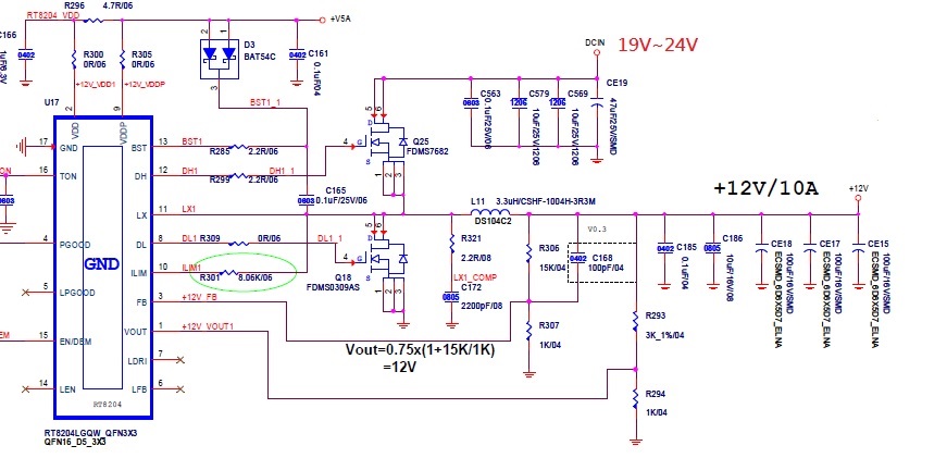

TPS53219A for 24Vin to 12Vout
Dear Sir
I want to use TI solution to do 24Vin to 12Vout / 10A ,Previously design is use RT8204L
But I can't find the low cost solution and seems like TI's TPS4007x is more expensive than RT8204L
Please kindly help to suggest cheap than TPS4007x and suitable solution for 12Vout
