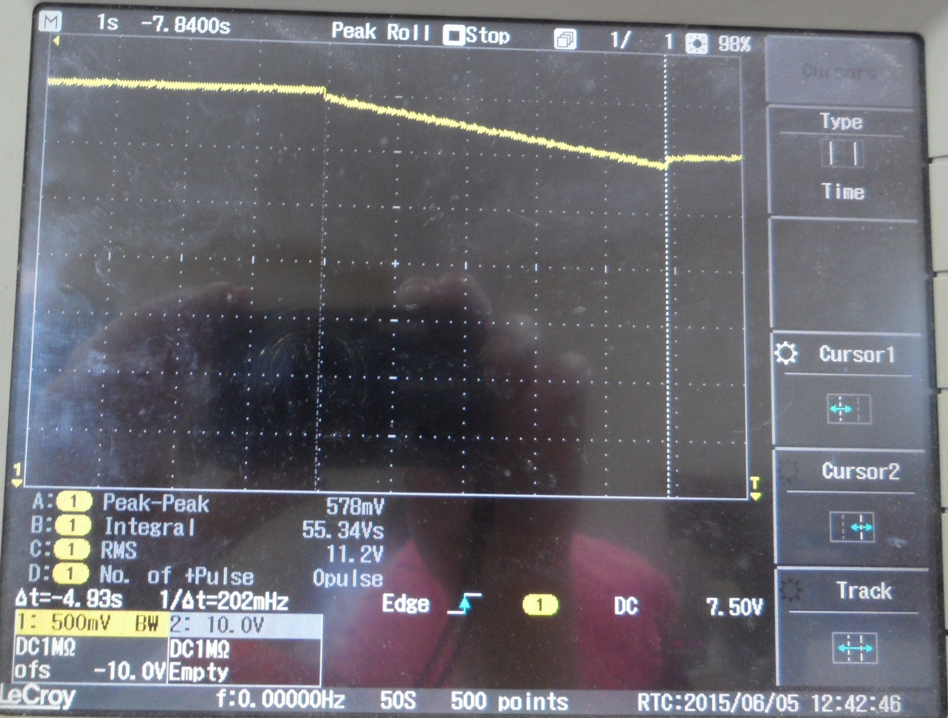

1. CAPACITANCE

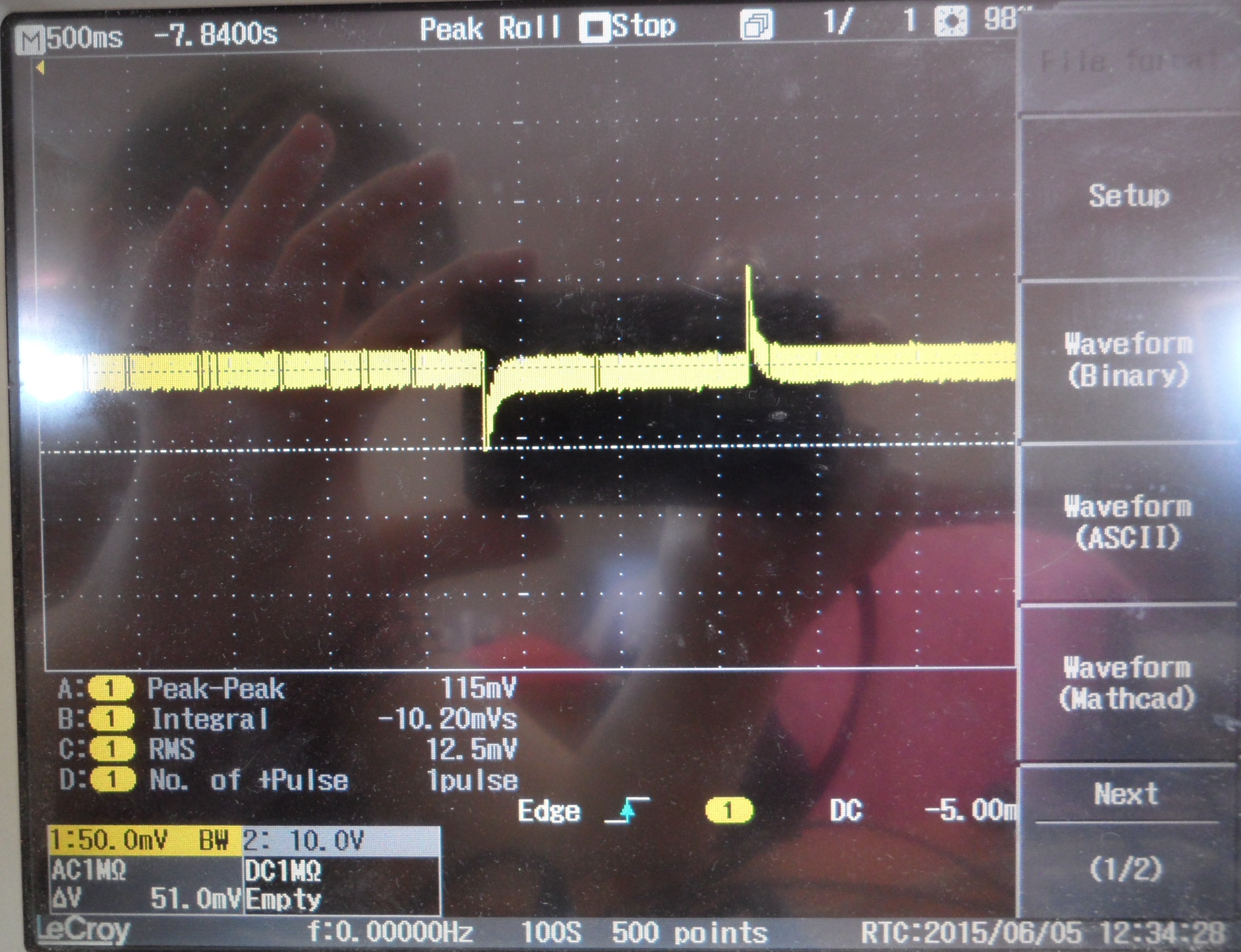

Why the calculated Capacitance differ from the real Capacitance?
Capacitance measured by the bq33100 is 44 ÷ 50 F
Capacitance measured on the oscilloscope is 5 Seconds * 0.5 Ampere / 0.5 V = 5.0 F
2. ESR
Why the calculated ESR differ from the real ESR?
ESR measured by the bq33100 is 126÷182 milliOhms
ESR measured on the oscilloscope is 51 mV / 0.5 Ampere = 102 milliOhms

  • Incorrect measurements could be caused by a variety of issues including mis-calibration, inappropriate learning load, improper connections etc. I suggest you scope what is happening during the learn cycle as a method of investigation. Attached is an application report that may be helpful.6710.bq33100 Top Ten Design Considerations.pdf

    If I understand correctly, since as the capacitor voltages and the charging current are displayed close to the real values, calibration cannot spoil a measurement.
    The learning process takes place in the sequence described in the datasheet and corresponds to the schedule in the figure 1.
    I read the bq33100 Top Ten Design Considerations.pdf  and haven't found a suitable answer.
    What am I doing wrong?
    Sometimes after Learn, there is an error in the 12 bit SafetyStatus, what it might mean?
  • Could it be that you have a load connected to the supercap stack when the learn cycle is run? There should be no system load, only the learning circuit.
    Did you modify the EVM to arrive at the 4 desired charging voltages, or is this a custom design? If its a custom, are you sure that the learning load is implemented correctly?
  • During normal operation, processor consumes 20 mA of super capacitors.
    The evaluation module (EVM) is made by your scheme.
