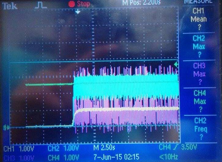

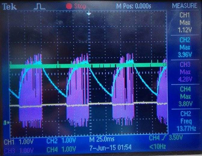

  • Fig 1. start up with no battery and with 10 kohm load
    Fig 2. powering up with a battery above uv

    I followed the EVM users' guide test procedures mentioned in section 3.3.1. Power-up With No Battery and 10kΩ Load on STOR
    and 3.3.3. Power-up with Battery more than UV (2.3V to 3V), BAT FET ON
    Fig 1. is the measurement i got for 3.3.1 and Fig 2. is the measurement i got for 3.3.3
    the blue line is for Vstor, green line is for Vbatt, pink is for Vphase (LBST pin) and yellow line is for Vindc.
    In Fig. 1, I can see the switching LBST pulses but Vstor continuously charges and discharges and doesnot reach saturation as indicated in the user guide.
    In Fig. 2, the LBST voltage switching doesnot look like the one in the user guide.
    Do you think the EVM is working ok?
