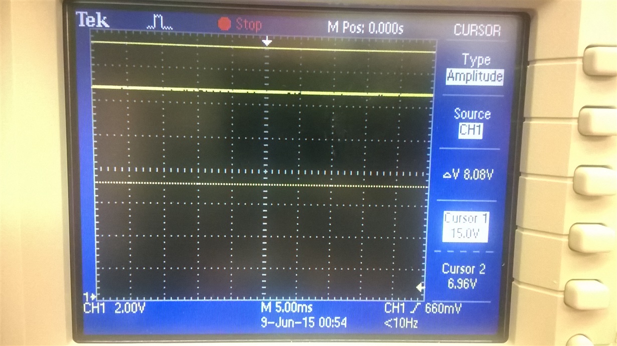

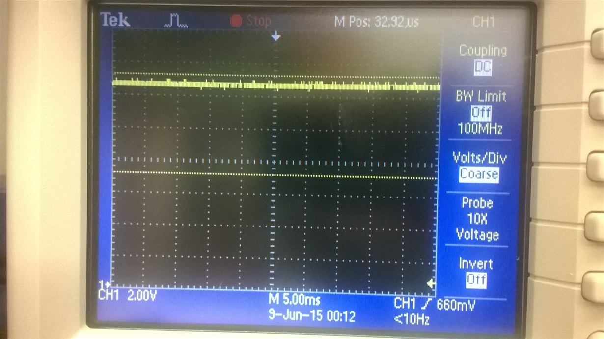

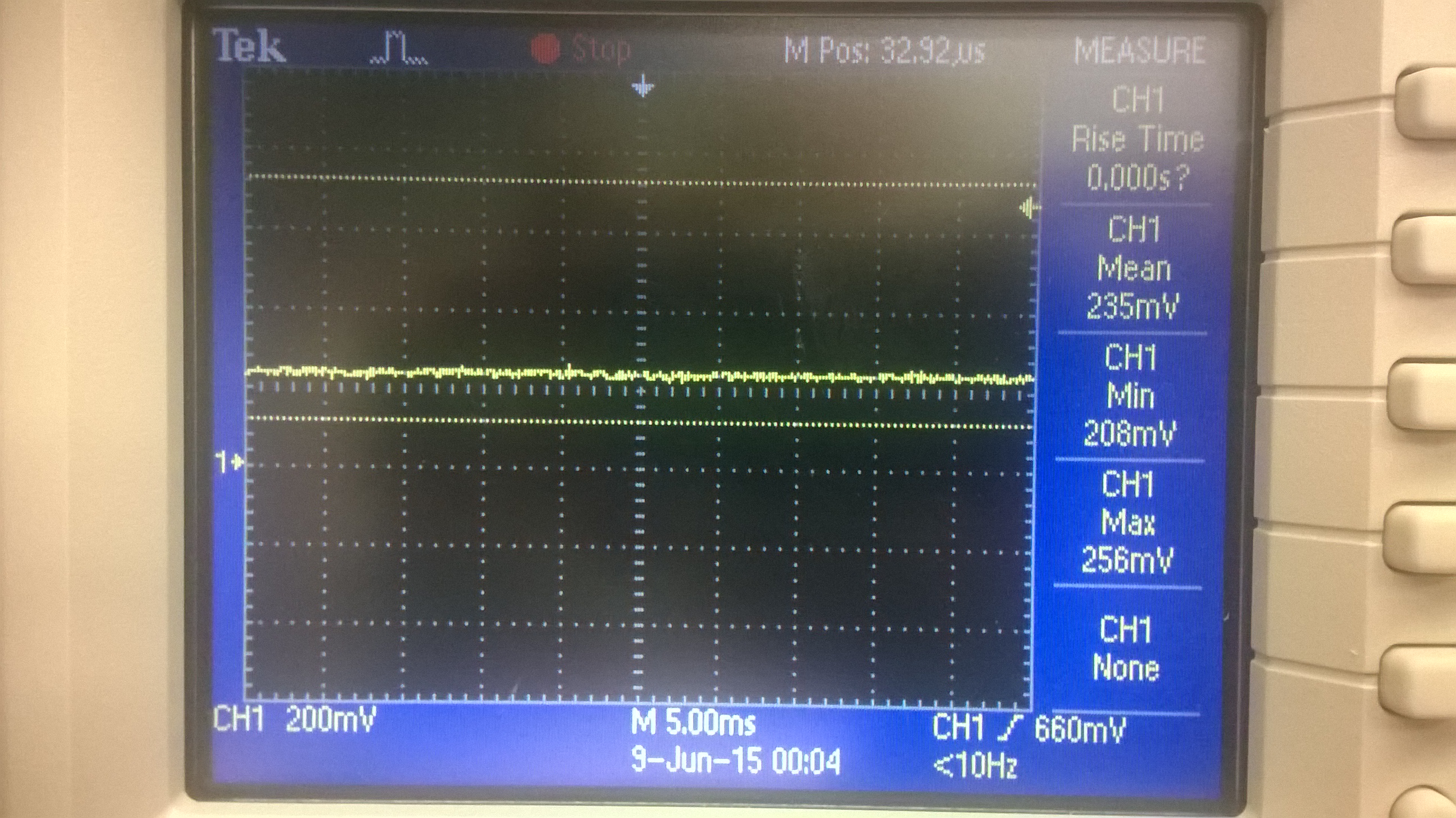

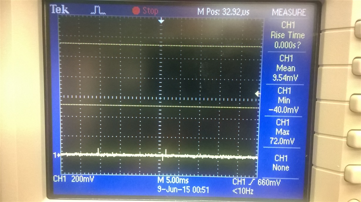

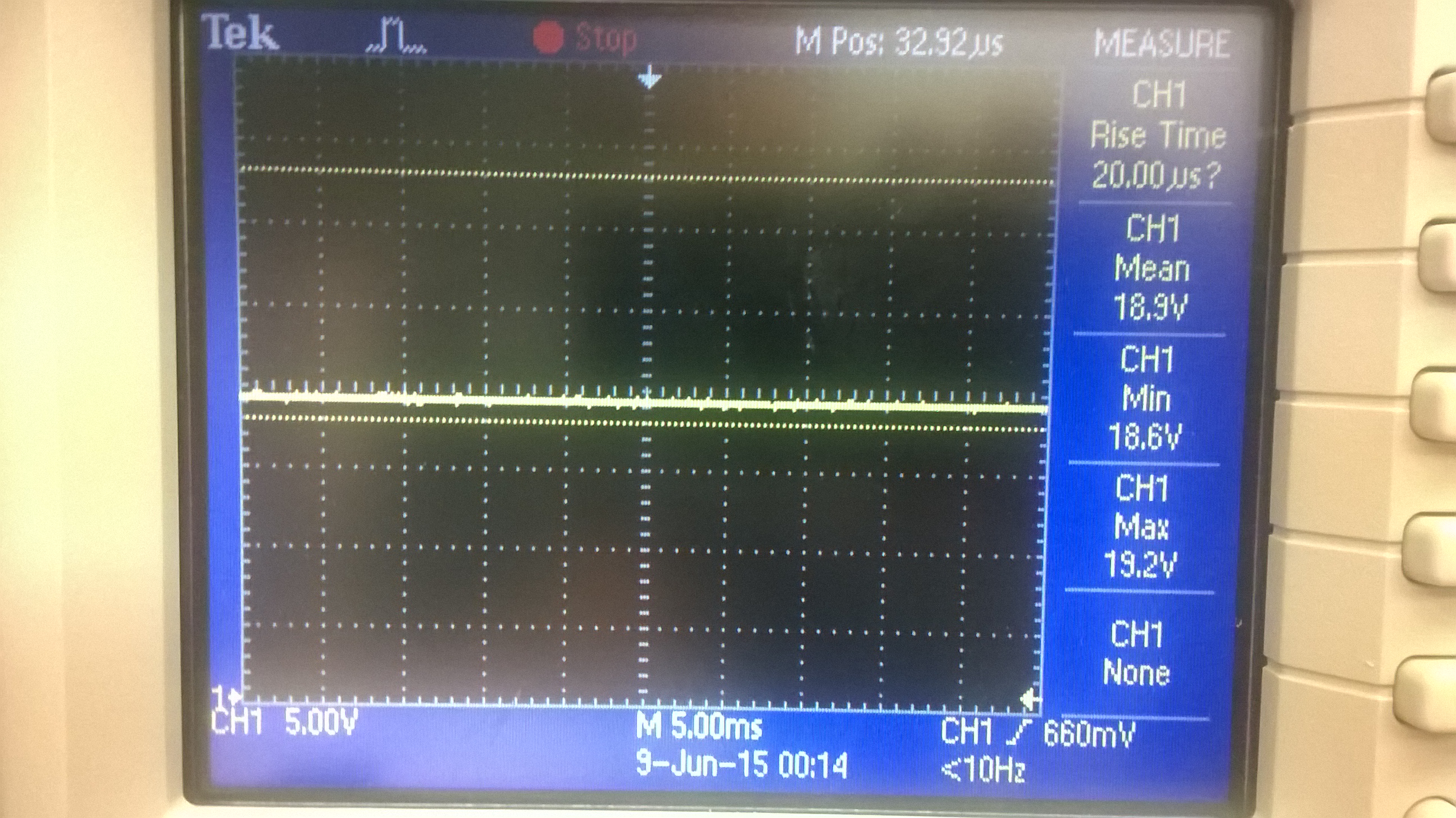

  • Rachel,
    Here are scope shots of VIN, \BATDRV and ACDRV with the power supply connected and disconnected.
    Steve
