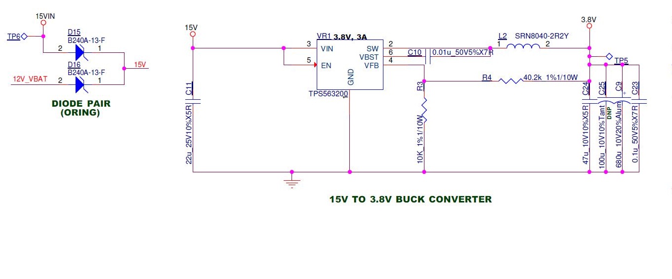

 We have made power supply card using TPS563200 to generate 3.8V, 3A from 11V to 16V supply range.
 1) When we give only 15V supply generated from 230VAC TPS563200 gives output as 3.83V without load and 3.91V with load(3.3ohm/10W).
 2) But when we test it with both 12V battery and 15V supply ORing logic, IC gets shorted at pin # 1(GND) and 2(SW). Why so much sensitive when connected a           multi-meter to measure voltage?
 3) And when we try to check feedback voltage across feedback resistor(R3) 3.8V power LED turns off and pin # 1(GND) and 2(SW) shows short.
