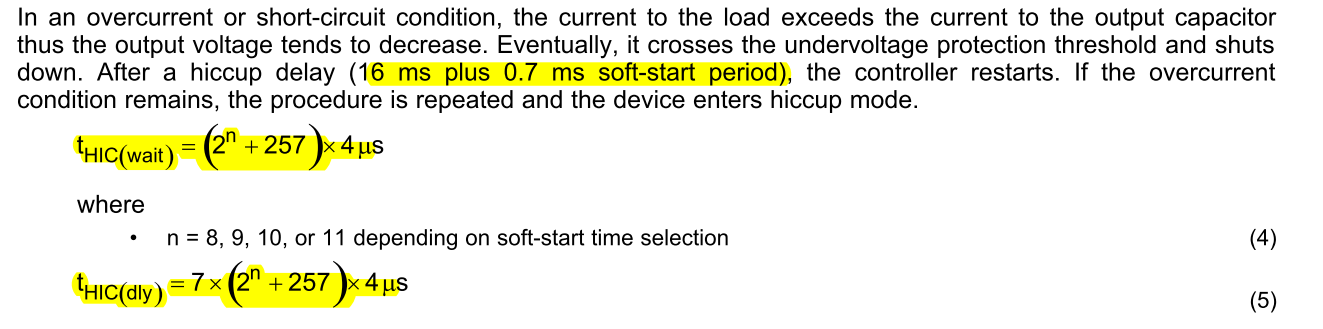

Could you tell me about TPS53319 tHIC(wait)?
What does this value mean?
Is the time period obtained by adding the tHIC(wait) and tHIC(dly) becomes Hiccup mode?
