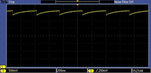

I have 3 instances of a new test pcb which use TPS76633 to produce my 3V3 rail.
1 board gives me 3V3, the other 2 produce an output higher than 3V3 that seems to roughly scale with the input.
An input of 3V9 gives an output of 3V5 (Obviously should be 3V3)
An input of 6V gives an output of 4V8
I have tried varying the ESR series resistor - 5R,10R,20R doesnt seem to make any difference
PG pin is high on both working device and non-working device
Device is cool to the touch so I assume thermal shutdown is not the issue
Im not sure if the device could be switching off due to internal current limiting. Measuring resistance from 3V3 to GND with power off shows the same on working test PCB and non-working PCB so it isn’t a short on the board drawing massive current and causing the Reg to shutdown.
Scope seems to show switching on and off of the output (See pic below)
I would massively appreciate any suggestions on this one.

    The question is what could you connect to the output of the 3V3 reg to make it exhibit the behavior shown in my screenshot where the output keeps rising higher then 3V3 then resetting to 3V3 in a repetative manner..

  • Hi Jamie,
    It sounds like something downstream is biasing the output downstream. From your waveform, it looks like the low point is ~3.3V. This implies that something downstream is charging and discharging.

  • Hi Jamie,
    TPS766 can supply 250mA; however, the LDO does not sink current.
    My intention was to point out that the voltage appears to be biased higher than the regulated 3.3V for most of your scope shot.  The low point of 3.3V is the only point on the curve where the LDO is regulating.  When the output is biased higher than 3.3V by something downstream, the LDO is not able to regulate the voltage as it does not have sinking capabilities.

    Ok that makes a bit more sense to me.
    I have fount if I hold my bluetooth module (which is powered from 3V3) in reset, the 3V3 regulates correctly.
    I should be ok now Ive isolated the issue.
