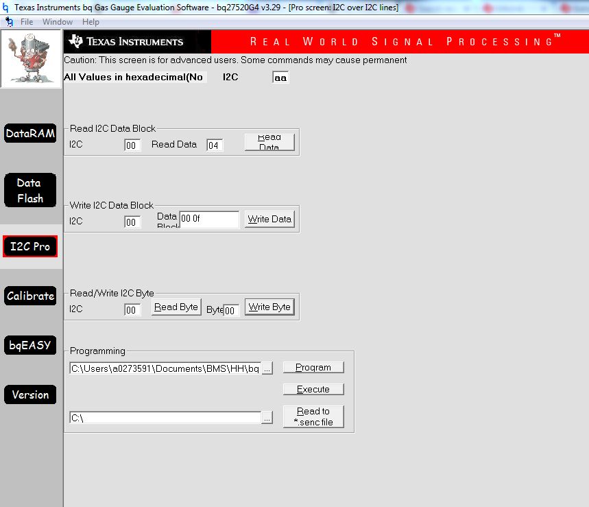

Hi Alexis,
You can program the senc file from ti.com on your gauge using bqEVSW, then extract the srec using bqstudio.This will be the original srec.
thanks
Onyx
