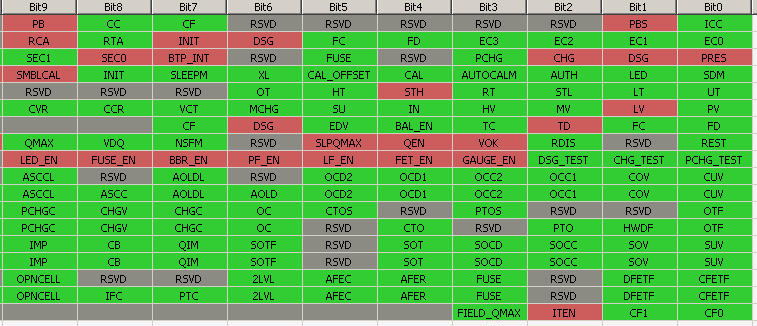

  • Hi Thomas, thanks you for recomendations..
    I'am attach two screenshot:
    Today after end of charge, I can't see flag VCT set, charge is switch off aprox ~550-600mA (default Taper current 250mA):

  • The charging current must drop below the Taper Current for at least 80 seconds for charge termination. If you have a log file and gg file to attach, then I can review them.
