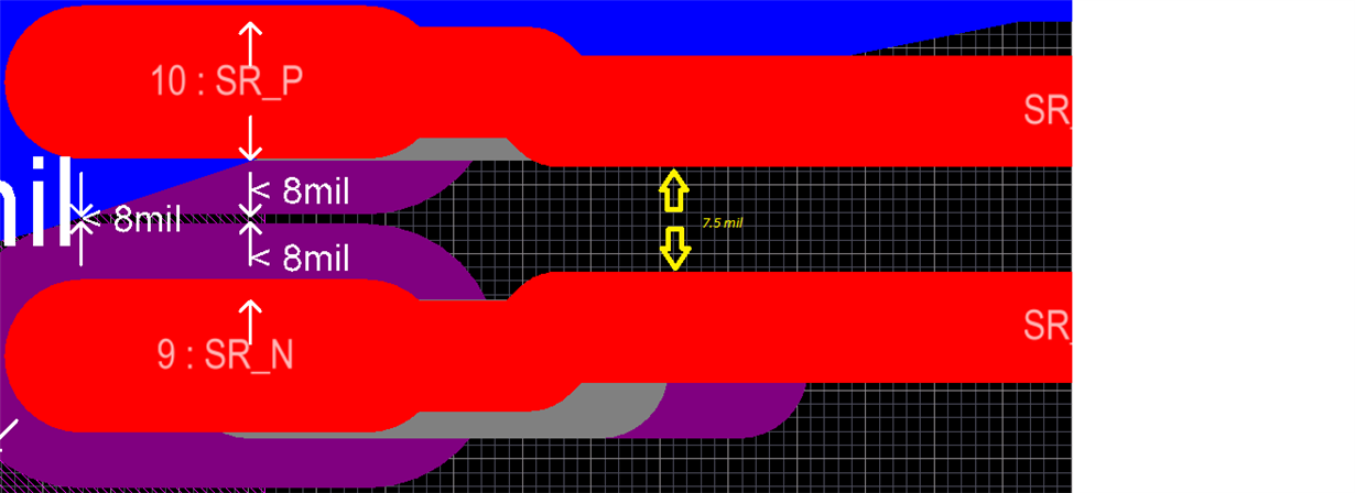

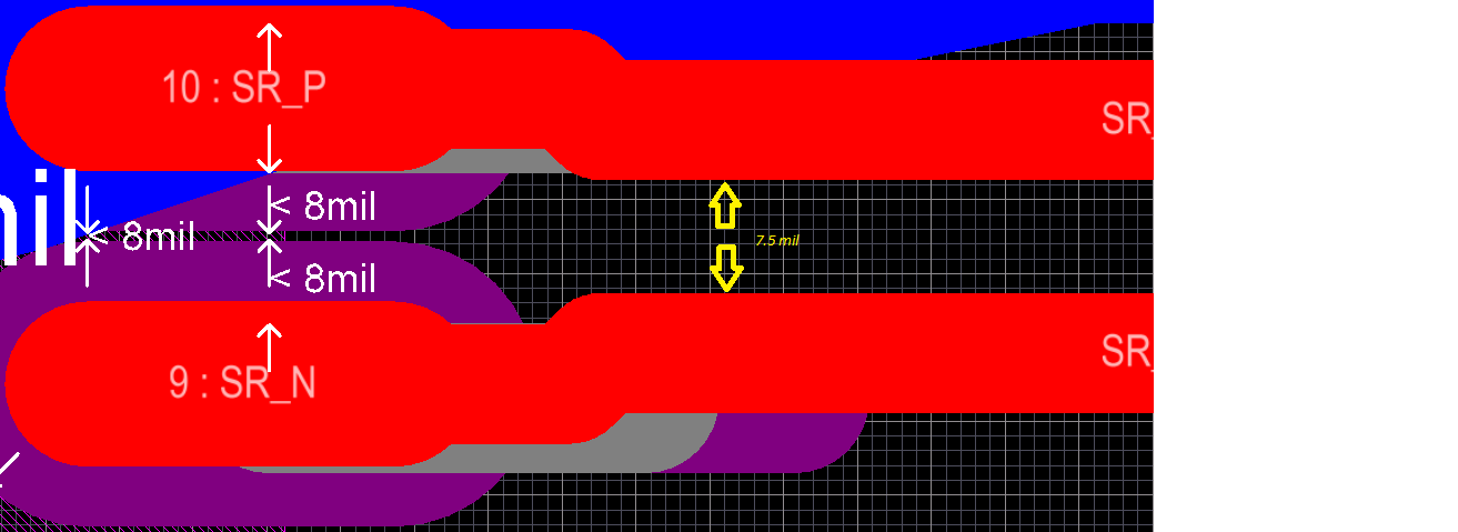

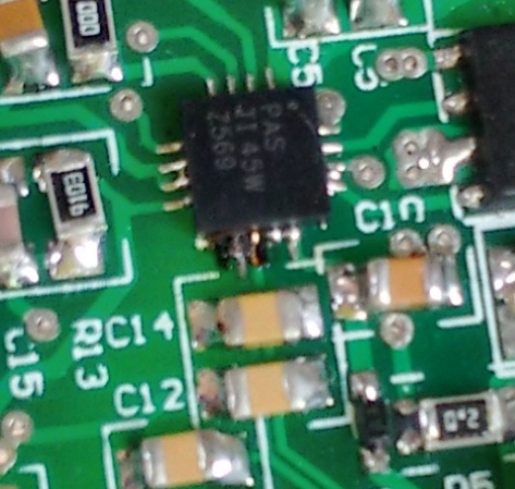

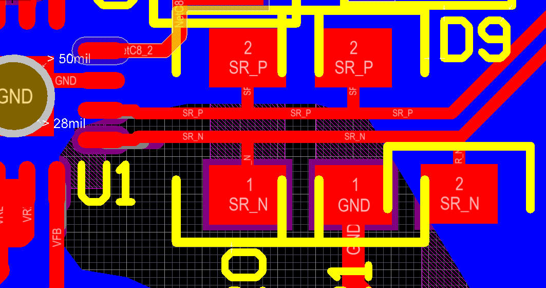

    The IC might be damaged and I could have made the mesuraments that you state but before testing the IC caught a little fire near the SRN and SRP pins as above:
    PCB soldered :
    PCB in CAD:
    Detail of SRN and SRP pins:
    Distance beetween pads of the IC = 8.858mil ( 0.225 mm)
    Distance between SRN & SRP tracks = 7.5mil ( 0.191 mm)
    Maybe was because it was hand soldered?
    Maybe the clearance is too low? What would you think was the problem?

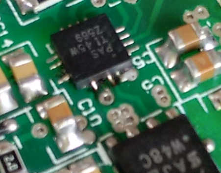

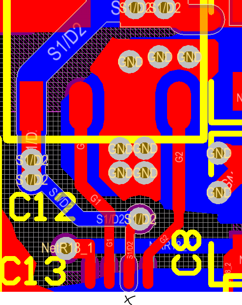

    Another board caught fire. And the most affected part were on the pins 13 to 16. As you can see above
    PCB soldered :
    PCB in CAD:
    Burned pin in schematic :
    In the case of this board damaged board, it worked at the beginning but when it failed,  the Charge LED stat blink at approx 1 Hz.
    I dont really have a clue why did this happen.
    Please let me know your comments. Always a pleasure Smritri.

  • My guess is that there was a solder short somewhere (maybe between PH and the termal pad under the IC?). You need high current for a damage like that, and the SRN/SRP are not high current paths.
  • Yes you are probably right.
    For the SRN SRP pins maybe short circuit was mistakenly connected.
    Thanks Smritri ! The soldering will be more carefull.
