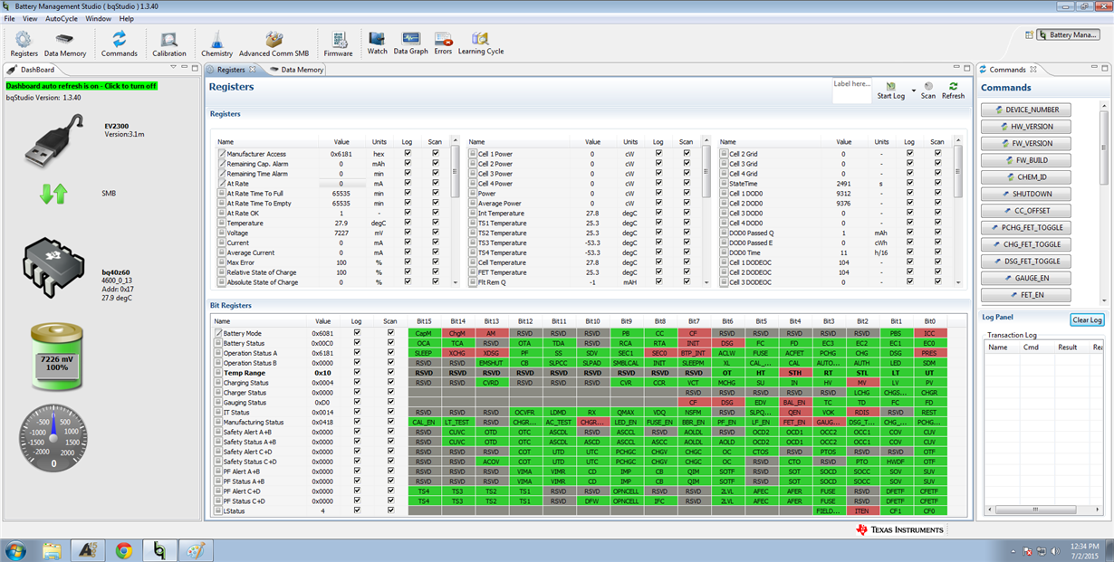

The EV2300 is arrived. bqstudio is attached, everything looks cool. CC, NR bits, chemistry are configured, but all of my fets are low. I can toggle dsg fet by chg_fet_toggle button, and when I do it, there is output as expected. How the hell can I "start" the BMS?
Zoltan,
The device has a hidden register that can disable the FETs and it had been overwritten. I am not sure how it got over written, but you mentioned that you had been writing to the flash, so maybe it was written by mistake. I fixed that register and also made a few other parameter changes in the attached srec file to support a 2S configuration.

Thank You very much, now It's working fine. But how it is possible to write a hidden register? There is an auth module, why hidden registers are writeable by default?
