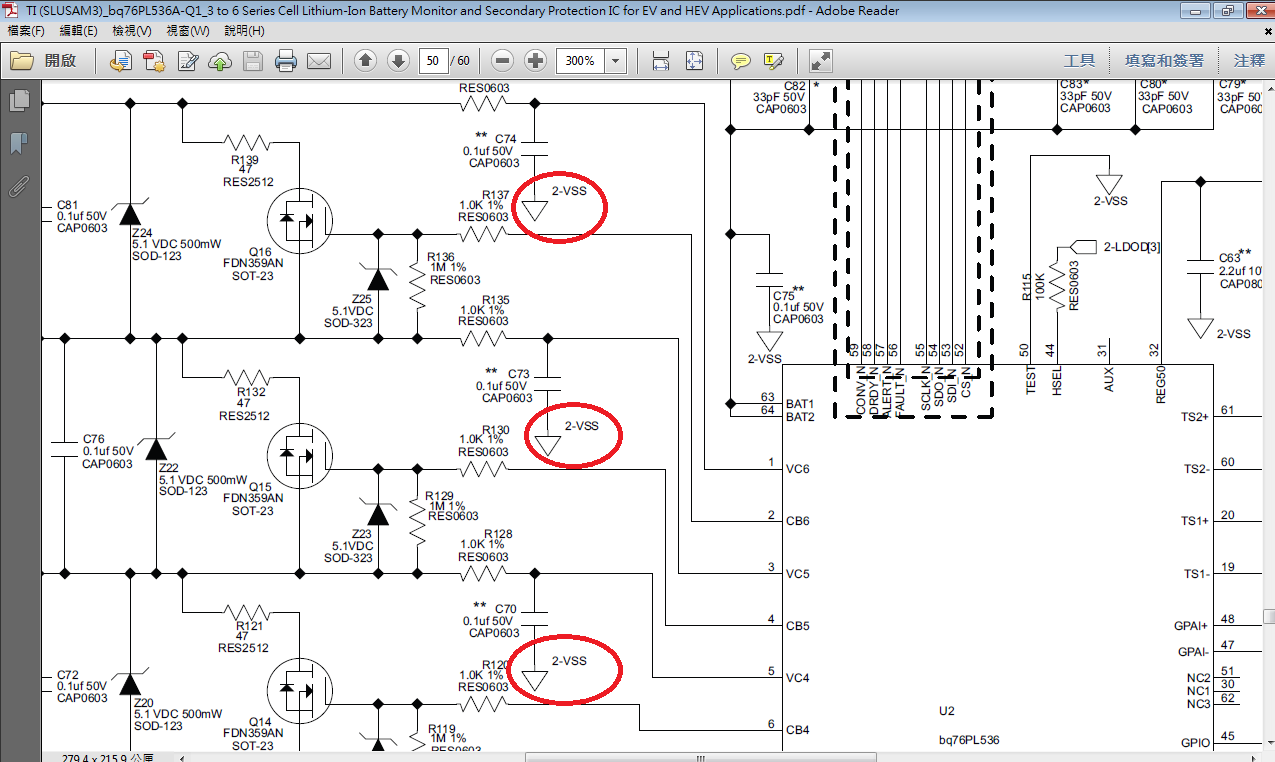

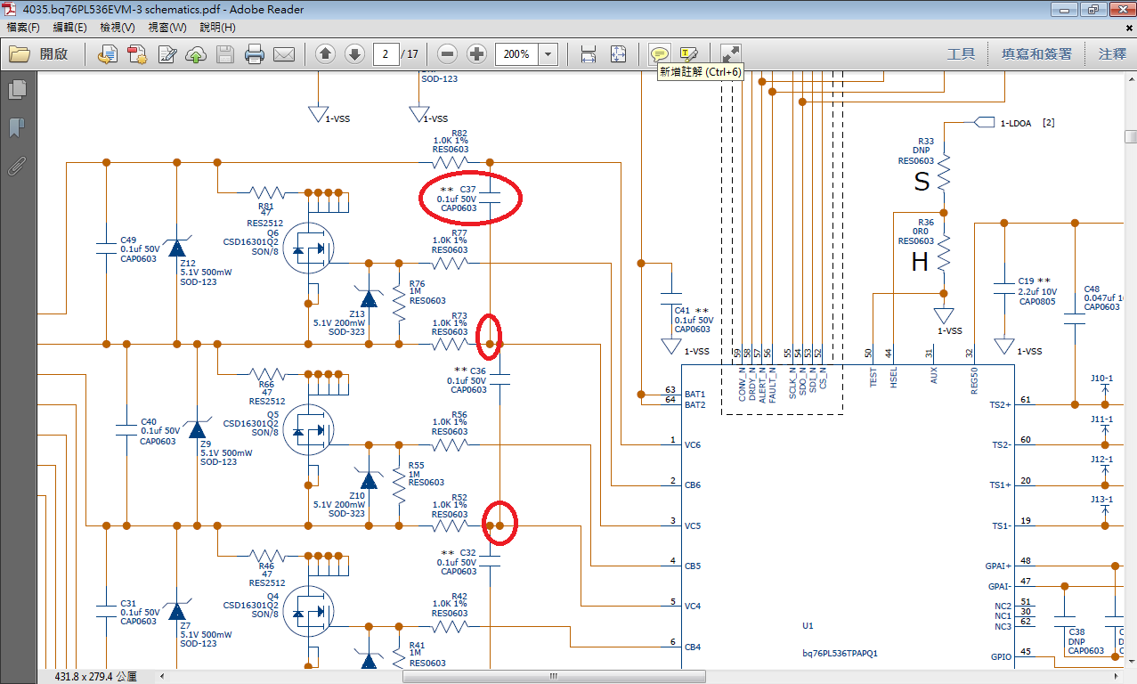

Is there something different for both two connections ?
Which one is prefer ? Many thanks !
Hi Terry,
Single ended filtering is our recommendation because of same cut off frequency.
Use the bottom circuit.
