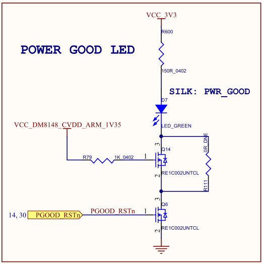

We are using UCD9081 in our custom board. I have attached UCD9081 codes UCD9081 Parameters_with_retry1.par , UCD9081 Parameters_with_retry0.par and also schematic with this thread.
I have loaded UCD9081 Parameters_with_retry1.par code in all three boards. Only two boards are working fine with this code, other board is getting PGOOD_RSTn from UCD9081 after some 5 mins. I could see in GUI that all voltages are within limits, but still POWER_GOOD led is not glowing. GUI is not showing any error logs
The same board is working fine with the UCD9081 Parameters_with_retry0.par code. The only change I did in this code is to change "retry from 1 to 0".
