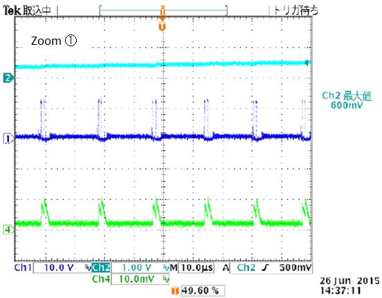

 My customer test start up performance under the following condition at EVM.
  channel: CH2
  Vin: 12V
  Vout: 1.05V
  Iout: 500mA
  fsw: 1MHz (I2C setting)
  other parts: EVM defult value
 Wave form is below.
 It is not normal.
 And when output is no load, output voltage is above 1.05V. It is not regulation.
 Could you tell us about resolution method?

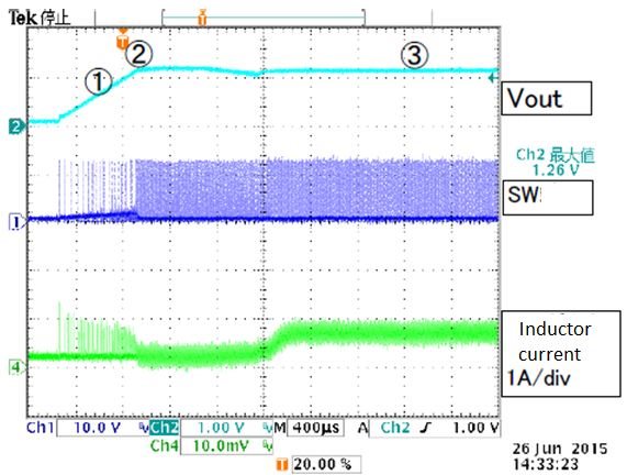

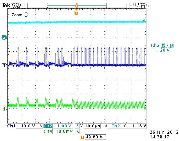

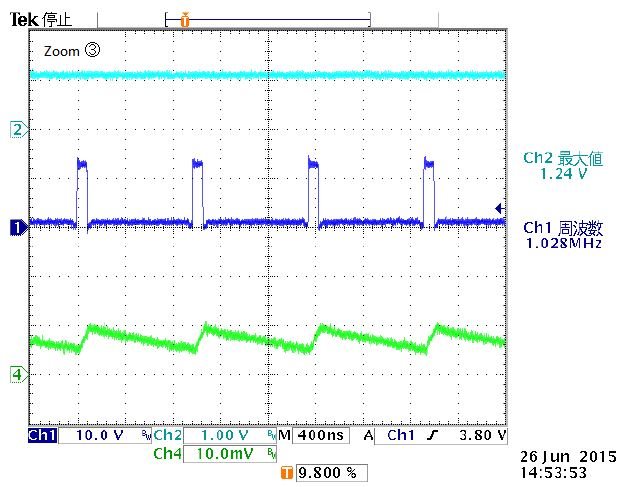

  • Thank you for your reply.
    This is including SW voltage and inductor current waveform.
    And EVM is under the following condition.
      channel: CH2
      Vin: 12V
      Vout: 1.05V
      Iout: 500mA
      L2: NR8040T2R0N
      R8: 3k
      R10: 10k
      C19: 470pF
      R35: 180k

  • Hi Taheo,
    From your waveform, when the loading is coming, the output drops a little, it's normal operation for our device. You can measure the drop value of output to see whether this drop can be accepted by customer's system.
    BTW, our device's Min-on time is 150ns, so when vin=12v, vout=1.05V, the max frequency for TPS65400 is about 600Khz, so we don't suggest customer use 1Mhz for this application. Why customer need so high frequency? is there any special requirement?
