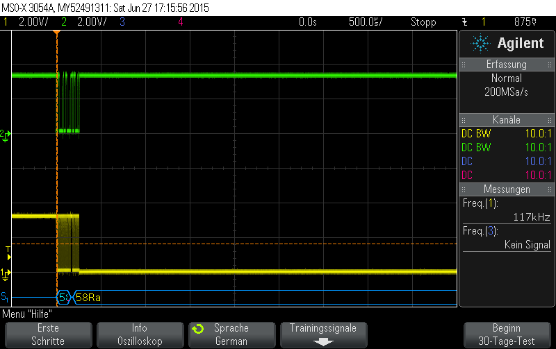

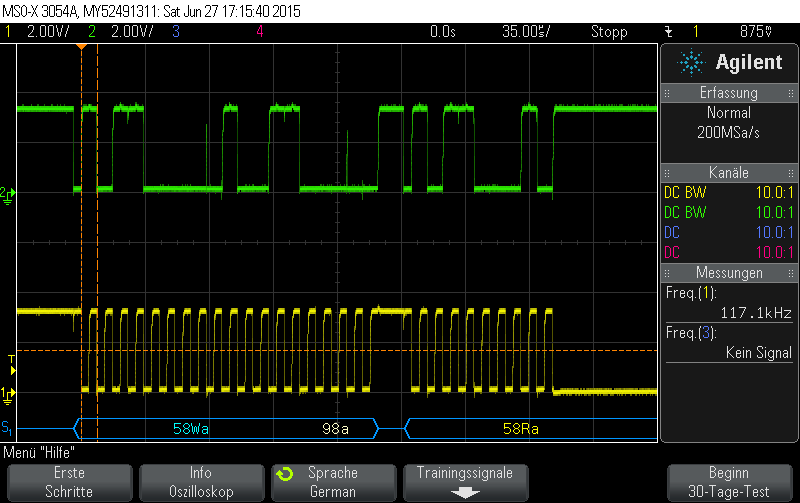

  • Hi Ian,
    after my PC in the lab brokes down, I am working again on that PMBus stuff.
    I found some PMBus master code and implemented it. I send a command for reading Information, here I use PMBUS_REVISION, 0x98. I get ACK back but no data. As I could not use a Debugger on the UCD3138 board I didn't know whats going on.
    Is there any issue with the PMBus and is there any simple alternative way to communicate with the UCD3138? I only have to be compatible to myself!!!
    With best regards
    Gerhard
    but no more info follows
  • Gerhard, which code are you using?  I'm surprised that that function isn't there, so far as I know, it's in all of our codes.  In any case, here it is:
    Uint8 pmbus_write_user_ram_00(void)
    user_ram_00 = pmbus_buffer[1];
    return PMBUS_SUCCESS;
    Uint8 pmbus_read_user_ram_00(void)
    pmbus_buffer[0] = user_ram_00;
    pmbus_number_of_bytes = 1;
    As you can see, it's very simple to read and write to a variable in the PMBus functions.
    There are switch tables for read and write commands - here is the start of the write one:
    // look at command byte from a write perspective
    int32 pmbus_write_message(void)
    switch (pmbus_buffer[0])
    case PMBUS_CMD_MFR_SPECIFIC_02:
    return pmbus_write_light_load_config();
    The read one is similar.  To add another pmbus message, just write a function like the ones above, and add its call to the switch statement.
    If you want to return more than 2 bytes, you need to put in a number of bytes in the first byte on a read.  This is to follow the PMBus block write spec.
    The pmbus firmware puts the message into the pmbus buffer and calls pmbus_write_message.
    For a read, it puts the command in the first byte of the pmbus buffer and calls pmbus_read_message.  the read function puts the return data into the pmbus buffer, starting at the first byte and returns.  Look at the functions called by the switch statements to see the details.
    If you make your own PMBus messages that access the variables directly, then you don't need to do anything to deal with the changing addresses.
    As far as testing pmbus commands, there is a screen in the device GUI called SMBus Debug.  It will let you send pretty much any individual PMBus message that you want to and tell you what it gets.  Not surprisingly, it's under the SMBus/I2C tab.
