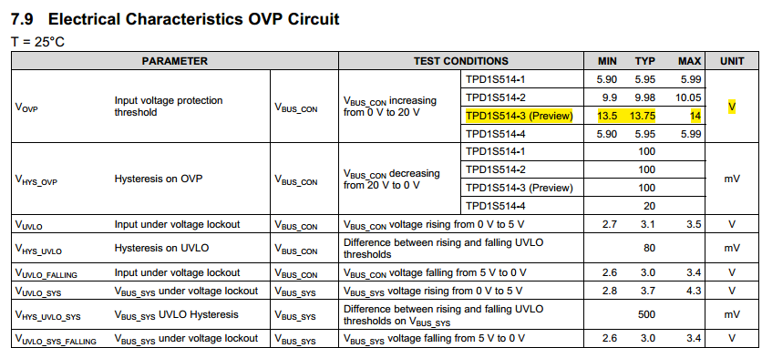

TPD1S514-3 OVP point
I got two OVP value for TPD1S514-3. Which one is correct? Thanks!
