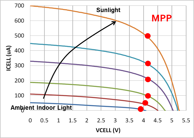

  • For example, as indicated in the plot above, at VOC, the panel does not output any current. Depending on panel manufacture difference, typically, the panel outputs maximum power when VCELL is around 80% of VOC. As panel output current increase, the cell voltage decrease. When the panel reach its max current, the cell voltage drops close to 0V
    You mentioned "by using a variable current sink, I have established that the peak current of the panel is approx 160-180mA, with a MPP voltage of approx 4.6V". Do you mean that when the panel is outputing 160 mA, your measured panel voltage is 4.6V?
    The MPP threshold set by VDPM is used to preventing the input source collapsing by excessive load. You can test it by limiting the input current and then increasing the load current. To test you can set the input power supply to 5V and current limit to 100mA. Then connect a source meter to VBAT. Set the sourcemeter Vsrc to 4V and current to 100 mA or higher. Then measure the input voltage with a volt meter, it should drop to the VDPM setting. The reason you do not see in put voltage drop to MPP on the bench is because you are not pulling excessive load to cause the drop on VIN.

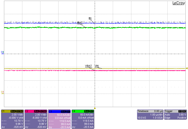

    Below is my test result with bq24210EVM and IXYS SLMD481H08L solar cell. VOC = 4.7 @ 30k LUX. I set VDPM  = 3.8V with 2K ohm resistor. VBAT is set to 3.5V. Charge current is able to reach 99mA.
