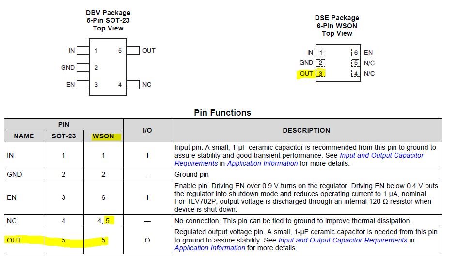

Page 3, Pin Functions table, WSON column, shows Pin 5 as both NC & OUT along with not showing any assignment for Pin 3:
The DSE package Top View on the same page shows Pin 3 tied to OUT:
I would assume the Top View is correct with OUT assigned to Pin 3, but I would like to verify this. Thanks
