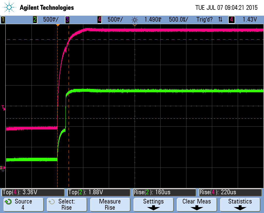

  • one more picture for V33D and BP in our application which is different from bench test; it's the start-up waveform and lockup happened;

  • Jun Yin,
    I see a glitch on V33D. V33D must be monotonic, otherwise it may cause problem. Please solve the glitch problem and see if the lockup problem is solved.
    Zhiyuan
  • Zhiyuan:
    Yes, there is glitch on V33D around 2.9V, the drop is less than 0.2V; it's due to the sudden charge of BP18's capacitor;
    While according to "Fig3-3 POWER ON RESET" in datasheet, there is Tpor time delay which is around 1mS when VGH which is 2.7V is exceeded to the device comes out of reset;
    according to the waveform I provided, the glitch is far away from where the device comes out of reset; you can see that from the rise time of channel 4(V33D); why it's lockup???
  • Jun Yin:
    I can't say for sure as I don't support this device. I was just offering you a clue to look into, as it is the case for UCD90xxx devices.
    2.9V is probably where the device enters brownout. Once the device enters brownout, it cannot get out until reset. You can check data sheet about this.
    Zhiyuan
  • Zhiyuan:
    I got your point;
    we have tried to power up UCD3138 externally with V33D=2.75V, it can't work firstly, but after pull reset pin low for some time, it can work normally; so even V33D< 2.9V, brownout flag is set, the device could still work due to V33D's above VGH(2.7V), although it's not in normal working V33D range;
    I'm confusing why POWER ON RESET can't bring device back to work, which has 1mS delay; apparently from the waveform we provided, V33D is stable and around 3.3V within 1mS after ramp-up;
