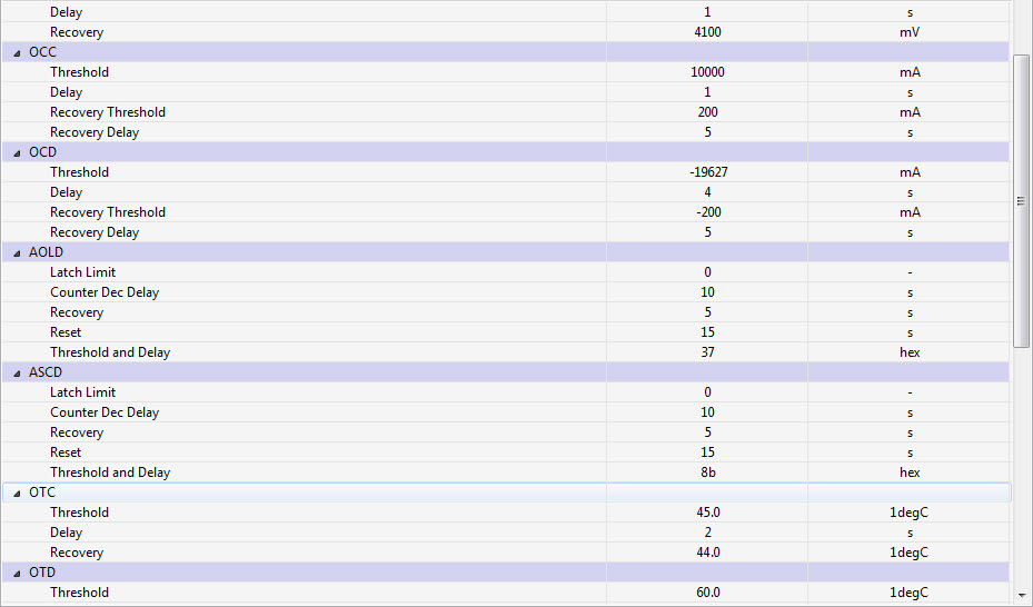

  • I experience the same loop on two different units but with the AOLD and AOLDL flags. Shutdown is the only way out.
    It happens sometimes during a smooth constant power discharge (BK8500 electronic load).
    EMC may have an important role in this issue since, in the AOLD case I experience, there is absolutely no overstress event happening. I'll look into that but that's quite a challenge...
    Just to let you know, our monitoring (MSP430 hooked to the BQ78350 SMBus) would see the flags loop but the current reading was stuck.  However, I don't know if the BQ was "nacking" all requests or if its reading was really stuck at the level when the problem occurred.  The reading was stuck at about 5A while the overload is configured for ~28A (see screenshot, sense resistor = 2mOhms)
    Anyhow, needless to say that we expect much from the next firmware release about this bug. EMC or not, such a loop is a problem.
