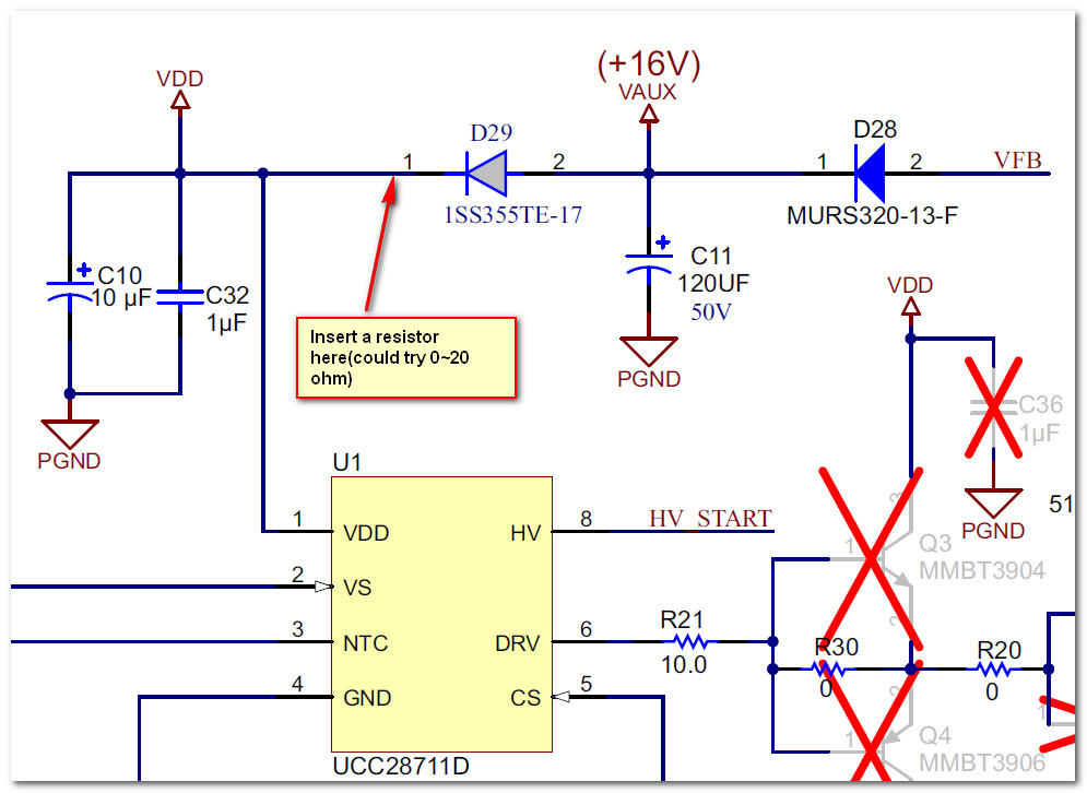

    I am using tidu412a design document from TI for my 137 watt SMPS.
    In this design, page no 19, equation 21 , to find a2 ( turn ratio of auxilliary to secondary) Vddmin is taken as 16V.
    wherehas in UCC28711 datasheet ( in page 20, equation 17 ) the same Nas is calculated by considerig VDDoff which is 8V.
    Then which things to be follwed to determine the turn ratio between aux and secondary.
    Hope it is clear now.
    Raja Saha
  • Hi Raja,
    Yes, they are using different ways to decide the Ratio.
    If use the UCC28711 datasheet's method, that means the minimum VDD voltage could be almost 8V which is near to the VDDoff threshold if there is not much leakage energy.
    If use the Tidu412a's method, the minimum VDD voltage could be almost 16V which leaves enough margin.
    My suggestions are you could use a value little higher than 8V to decide the ratio. you may choose 10V or 12V to calculate.
    However you must measure the real VDD voltage at the full load and no load to make sure the VDD votlage always in the working range.

  • Some ways to decrease the voltage at full load.
    1. increase the resistor series with the aux diode.
    2. Decrease the ratio of AUX:SEC
    3. Decrease the leakage inductance.
    I don't know the resistor value, you may try method 1 and Method 2 First.
  • I have exactly the same thing as said in point 1.
    By doing this the output(secondary) voltage is increased, but still the aux voltage is coming near 30V.
    It seems to me that number of turns in aux is more than the required.
    Here only I am confused, that I have followed the same rule in the design document but still the number of turns are not as per the requirement.
    Please help.
