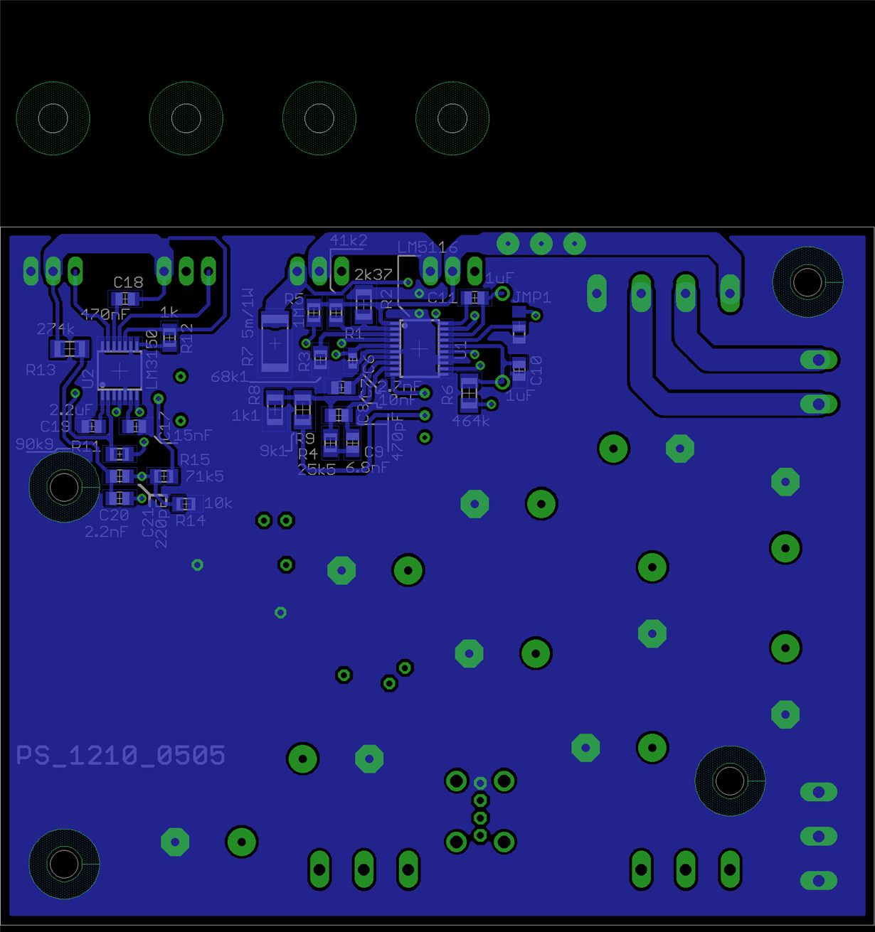

 I have design PSU 5V/5A with LM3150 with WEBENCH® Designer. When I apply power on input LM3150 won't power up. I check with oscilloscope HG, SW and LG and I don't have anything on this pins.
This is schematic: http://prntscr.com/7sh3qg On input is 24Vac, bridge rectifier, 5x 1200uF and 2x 100nF. This part is "shared" with 2nd rail 12V/10A with LM5116.
Any1 can help me to figure why this PSU won't power up?

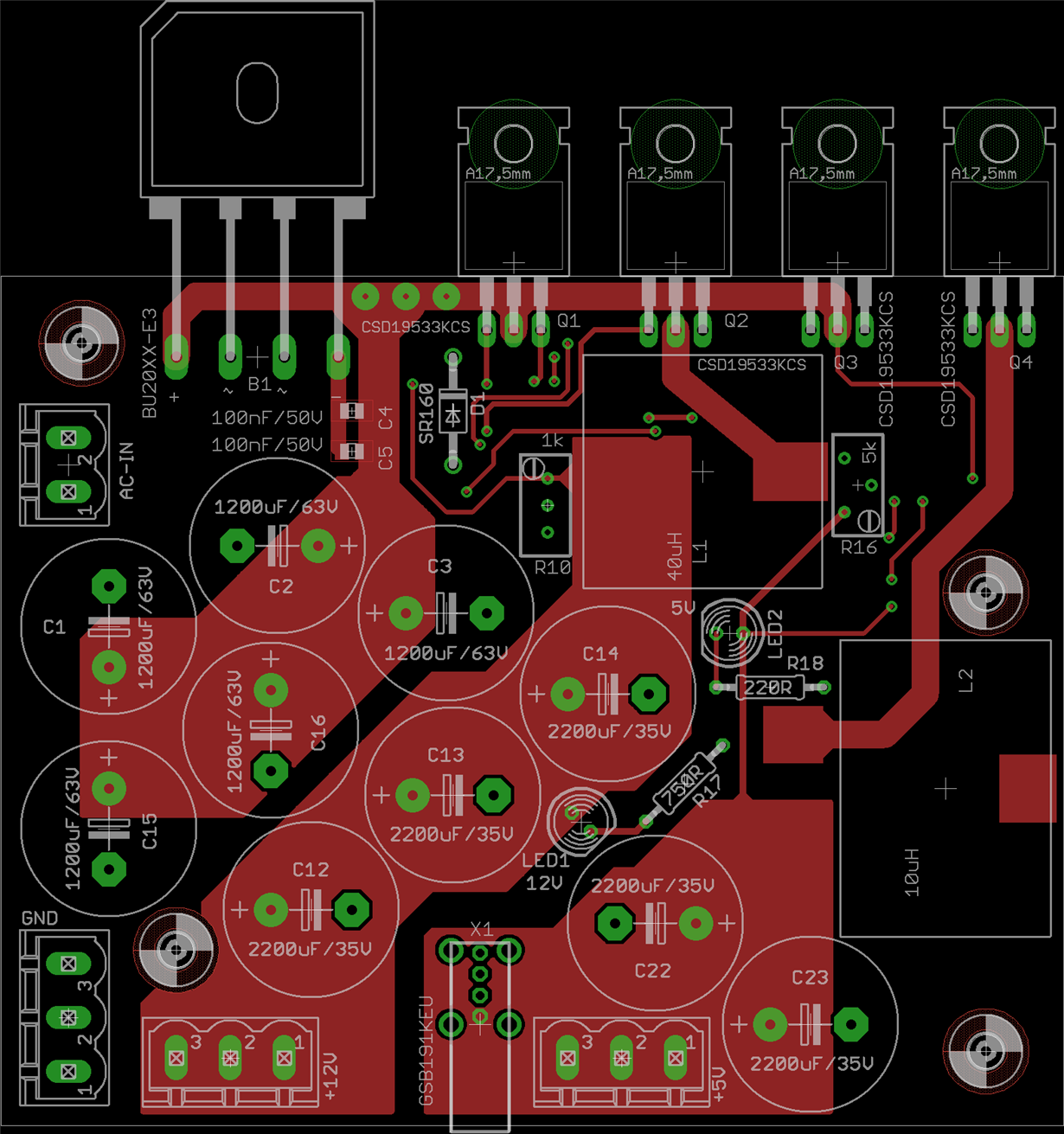

  • Hello Denislav and Marc,
     I don't have problems with sharing design with forum, it's basically TI design :). Here are PCB layouts and schematic.
    Webench Design no. for LM3150 is 823311/59 LM3150MH/NOPB. I change MOSFET's, Cin and Cout. And I add one multi-turn trimmer for fine Vout adjustment. On schematic after bridge rectifier write +24V, actually input is 24Vac and after bridge is little less than 34Vdc. So in schematic +24V bus is actually +34V.

  • I'm still looking through the layout but I saw two possibilities on the schematic.
    1)  First. Try Adjust the Soft Start Time.  With the 15nF capacitor, I am calculating 1.2ms startup. This is too fast for the amount of output capacitance you have. Try a 10 larger value.  It might be that the part is stuck under .6V reference and can't startup.
    2) What voltages are you seeing on other pins.?  Is the Vcc pin voltage around 5V?  If not is it Zero or some non-zerovalue.  If it is zero then maybe the part is not soldered correctly.
    3) En should work floating as you have in the schematic but perhaps there is some solder or flux on the pin.  Probe the pin and see if the part is being enabled.
    Marc

  • Based upon this failure,
    You need to add some ceramic Vin bypassing right next to pin2 to ground.  The pin is currently connected to a long trace Drain of the FET.  This is going to be noisy,  Try using a .47uF leaded ceramic. Also, this meand that you probably will want to add some ceramics from Vin to Ground across your High side and low side Fet to decrease the amount of noise in your layout.
    Marc
