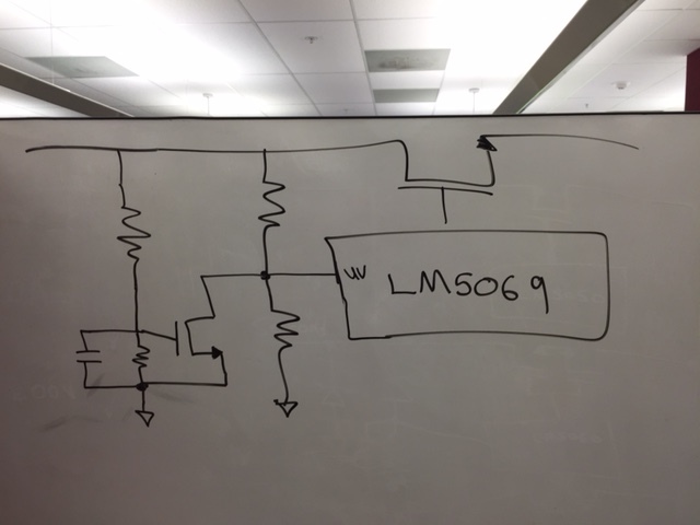

    If you are willing to use the OVLO function for this then one option may be to set the OVLO to 32V but add a cap to form an RC filter delay.
    Or to keep OVLO function, a different method may be to add another resistor divider + NFET and tie it in to the UVLO using the same RC filter delay:
    Alex
  • Thank you alex for your clear answer.
    I did some calculations on the suggestion of adding a delay in the overvoltage trip limit.
    However with all the tolerances of the capacitor, the OVLO threshold and the gate capping zener voltage, it was not possible to choose an RC delay that would not shut off in the surge condition during operation and turn off the mosfet in time when a DC overvoltage was applied from a cold start. (while not increasing the output capping voltage to have more margin).
    Therefor I decided to put in a temperature alert switch(TMP302D). The opendrain output interfaces to the UV pin like in your drawing. This prevents the mosfet getting too hot. I think this is the most robust solution, since the SOA protection of the LM5069 holds the mosfet safe in the short time (surges), while the temperature shutdown takes care of long time safety. (DC overvoltage)
    best regards,
    Tom
