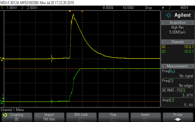

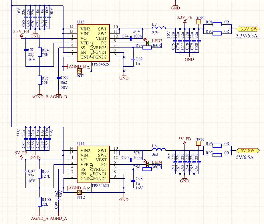

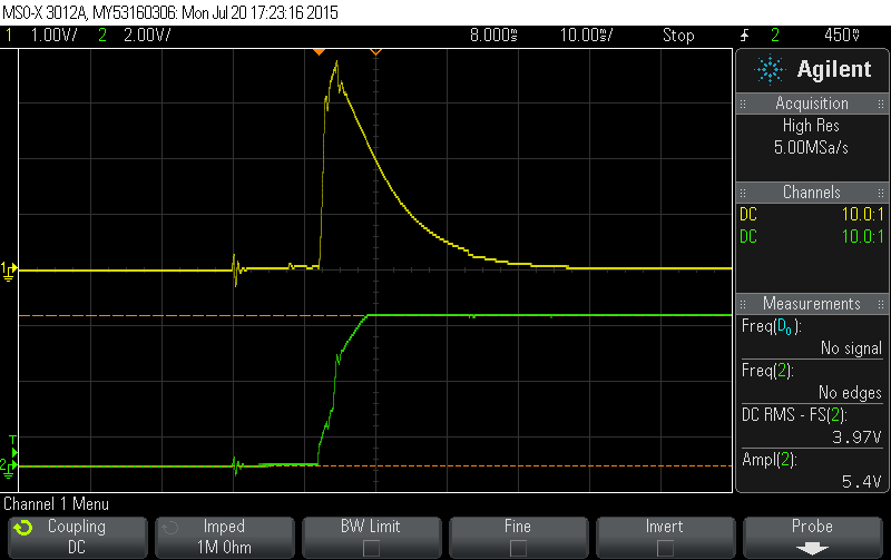

I'm using two TPS54625, one for Vout=5 and one for Vout=3.3. The schematic and layout are from datasheet. The Vout=3.3V works perfectly, but the Vout=5V doesn't starts.
Do you have any solutions for the problem?
The schematic is attached below.
