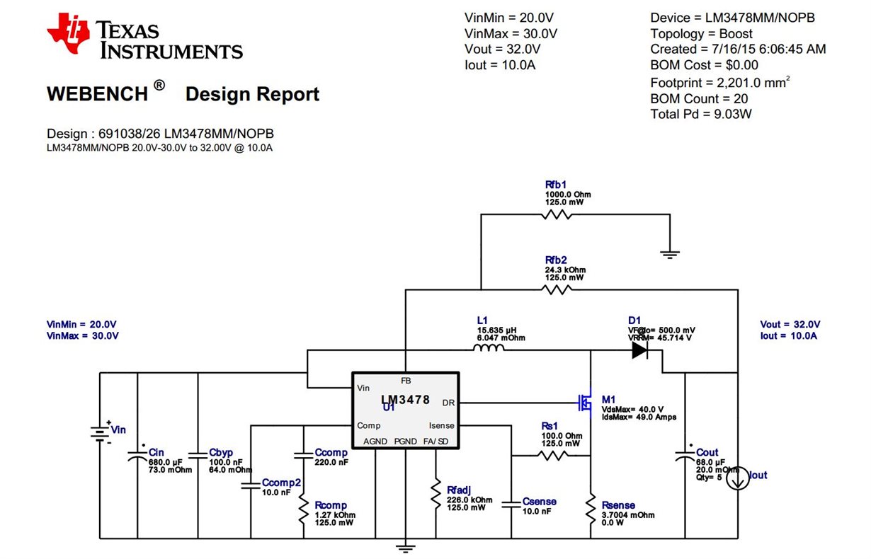

I'm developing a SMPS and I need the following features:
- Vin: 20~30Vdc;
-Vout: 32V;
- Ioutmax: 7A;
Using the Wbench tool, I got a circuit using the LM3478 chip. As I studied its datasheet, I realized that the overcurrent protection cuts off the output switching signal until the next cycle.
I guess this is supposed to work like a hiccup protection (when the output voltage is pulsed, because the output switching sinal turns off, and then try to turn on again, and so it goes...)
So I would like to know if it's possible to implement a timer between these pulses, is there some way I can do this with this chip?
If it's not possible to do this timer with this device, do you recommend me some other design?

  • Hi, Mr. Blattner.
    Thank you for your support with precise information.
    1) Still related to the current limit value, the design I got from the Webench tool is shown below:
    It's not clear to me how to calculate the Rsense resistor (3.7mOhms @ 10A). Can you help me to come to this value according to the situation above?
    2) Unfortunately, even in the second step you described in your answer (in which 4 clocks cycles are skipped) the output voltage would oscillate in a frequency considered too high for the device I'm powering.
    The approach I intend to use is a high-side measurement current shunt monitor chip (eg INA168) which provides a voltage to a comparator that triggers a timer chip (eg 555). Then, by applying some voltage (555 output) at the FA/SD pin, I would have a over current protection associated with a programable cutt-off time (that is what I need in this case).
    Can you see any impediment or malfunction aspect with the approach I described you above?

  • Hello Mr. Figueiredo,
    Concerning Webench’s calculation for RSEN, RSEN is chosen to guarantee that maximum current can be delivered under worst case conditions.
    Step 1)  Calculate peak current under worst case operation:
    Step 1a) Average current is Iout/(1-D) where D is 1-Vin/Vout. Worst case is at lowest input voltage. Also, I added 0.5 V to the output voltage to account for diode drop and subtracted 0.2 V from input voltage to account for drop across the FET. I get 16.4 A as maximum average inductor current.
    Step 1b) Current ripple is Vin*D/L/frequency. Again 0.5 V is added to output and 0.2 V is subtracted from input. Again, lowest input voltage is used for this calculation. I used 100kHz as your frequency. With 20 V input, peak to peak ripple is approximately 5 A.
    Step 1c) Peak FET current is Iav + Ipkpk/2, with 20 V input, peak current will reach 18.9 A.
    Step 2) Calculate RSEN
    Step 2a) Using Equation 19 from the most recent datasheet – available at TI.com, RSEN = VSENSE/Ipk*(1-D*VSLRATIO). Using minimum VSENSE and maximum VSLRATIO from the EC table, (w.c. VSENSE = 0.125 V and w.c. VSLRATIO is 0.7) maximum RSEN to allow 10A operation is 4.81 mOhm.
    Step 2b) Allowing 30% margin for dynamic operation and variation in passive components, the maximum RSEN is 3.7 mOhm.
    I have checked to startup from shutdown and found the parts starts up normally with soft start.
