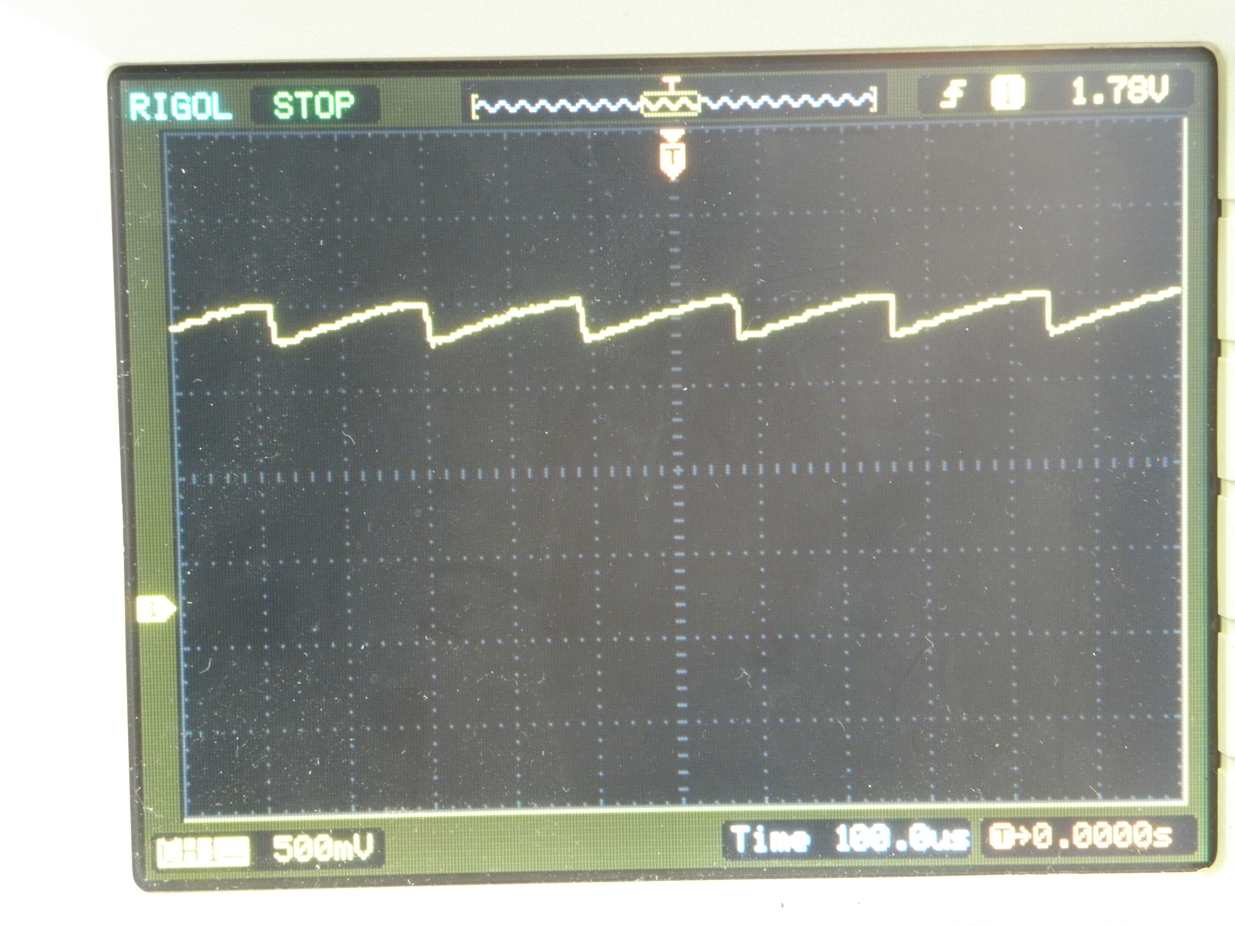

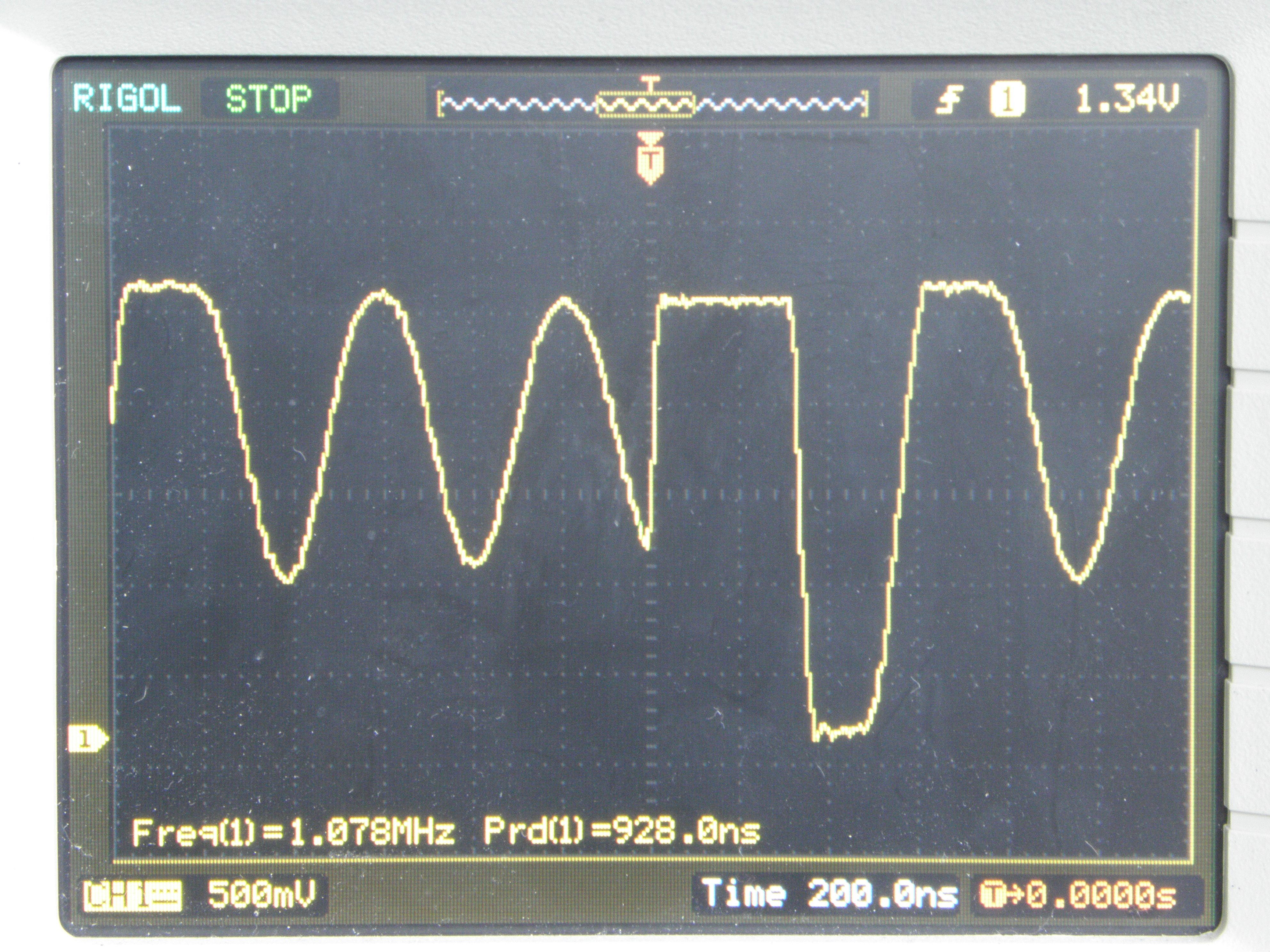

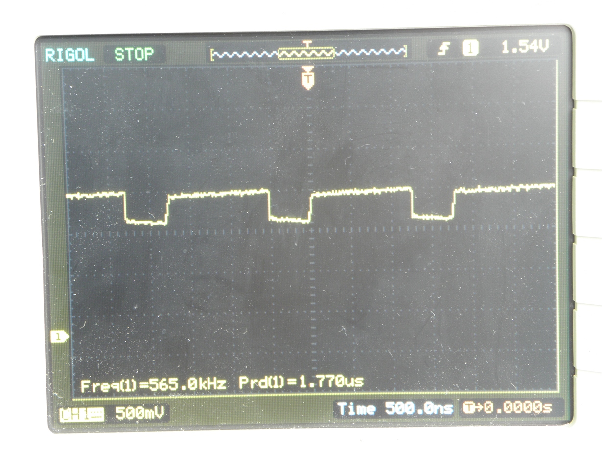

Hello Everybody,
I have some problems with the BQ24617EVM.
I did everything according to the datasheet, but now it seems the second board to be broken again.
To load 4 Li-Ion cells I changed the resistors R25 and R28. R25 is now 715K Ohms and R28 102k Ohms.
So I get 16.8V to charge the batteries.
Then I connected a power supply with 24V and 3A to J1. After that I connected a power supply with 1.8V on J4 (TS).
Then still connected the batteries and set the jumper 5.
Now everything seemed to work.
The charging current was 3A and the voltage slowly increased.
After about half an hour of charging it suddenly stopped and the LEDs ACDRV, BATDRV and STAT1 are flickering alternating.
If I remove the batteries or JP5 can be heard a high-frequency tone. This was not previously the case.
Nothing changes if I reconnect the power supplys.
Now I think this board is also broken, but without external influence. Nobody touched the board during charging.
Does anyone have an idea what causes this error here?
